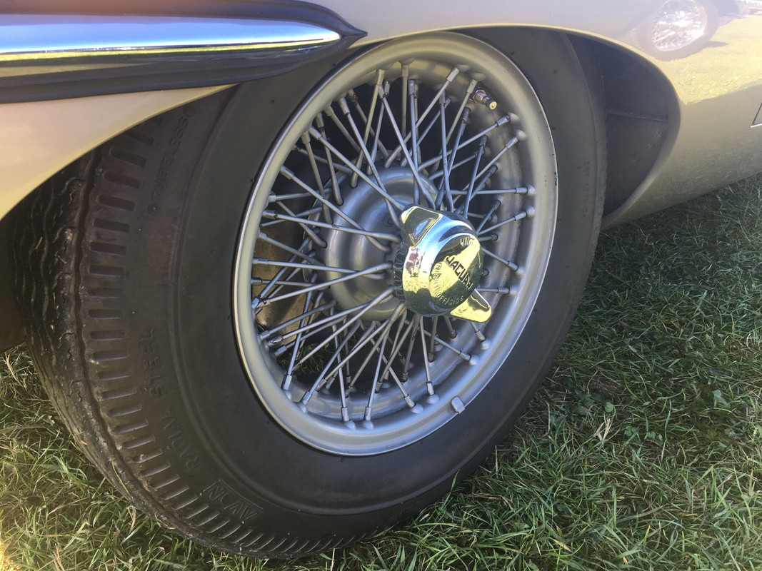

Yes same. I had 6” CWW with 205’s on my red S1 2+2 (too much bling) and on my current 3.8 FHC when I bought both of them. On my 3.8, I swapped them for 6 1/2” curly hub, centre laced with the 205’s (which really filled the arches) as the 6” wheels the 3.8 came with had incorrect easy clean hubs. I then decided in a quest for a more original appearance and also steering weight, I’d go back to 5” Dunlop chromes with Michelin XVS 185’s which I’m running now and they perform great. However, when I see (very rarely here) a S1 with painted wires and period looking 185 tyres I really like the look.
I saw this OTS at Goodwood a couple of years ago in the same golden sand as mine, fitted with Avon 185’s looking very much like crossplys. This is the look I’m going for:

#4 Re: Wheel size
Currently running 5.5 " competition ,silver painted wires on rear and 5" standard wires on front. Tyres are 6.00 x 15 Dunlop Racing R5s. Give a very 'full arch ' look as per 4 WPD and Graham Hill (he probably had 6.50" on rear). Not strictly road legal and tramline quite a lot but lovely turn in and grip!

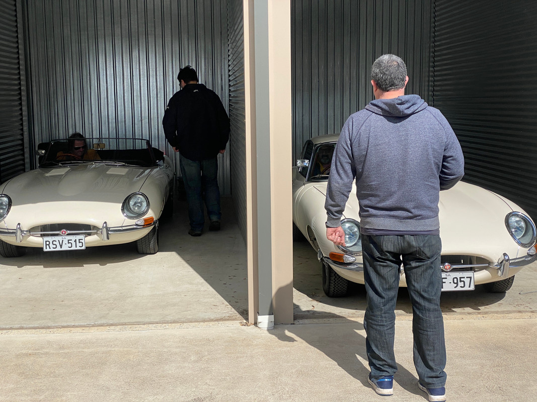

#6 Re: Wheel size
Here's a bad photo of my 3.8s. Roadster has 205 65 15 on MWS 6.6s and coupe has standard rims with 185 R tyres.
