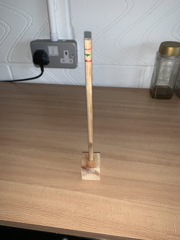

On our car, we have a Rob Beere adjustable reaction plate to adjust the torsion bars in-situ and we then use the following homemade device to measure the gap from the ground up to the suspension measurement point as shown in the Jaguar Service Manual.
The green line represents the factory recommended height from the ground to the suspension joint and the red line represents the 1/4 inch factory tolerance either side of that. By simply standing the tool under the car you can see whether the ride height is correct/within tolderance on each side and then adjust the reaction plate accordingly to either tension up or slacken off the torsion bar on each side.
NB by using the factory ride height recommendations, this assumes you are using the correct tyres with the correct height sidewalls and tyre pressures. If you are using lower profile tyres, an appropriate adjustment would need to be made to compensate for this.
The advantage of this approach is that this takes into account the type/age of torsion bar you are using since it only looks at the end result (i.e. the ride height).
