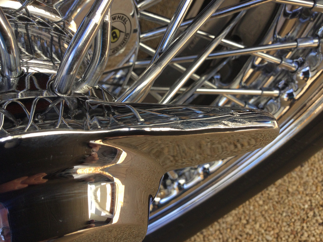

I recently purchased a set of two eared spinners from a very well known wheel supplier to replace the later type on my S2. Wanting to keep them looking good a Wheel Widget was acquired from Lionel which I must say is superb and duly used it to fit the spinners. As a final peace of mind on checking them after a drive I used my lead mallet to check tightness and was shocked that the lead bruised and marked the chrome ear of one spinner. I am therefore suspicious and disappointed that the chroming of these spinners are not up to a hardness standard as many of the spinners I have encountered over many years of cars fitted with wires. I have complained to the supplier but after a couple of weeks I have not had a response. Thoughts?

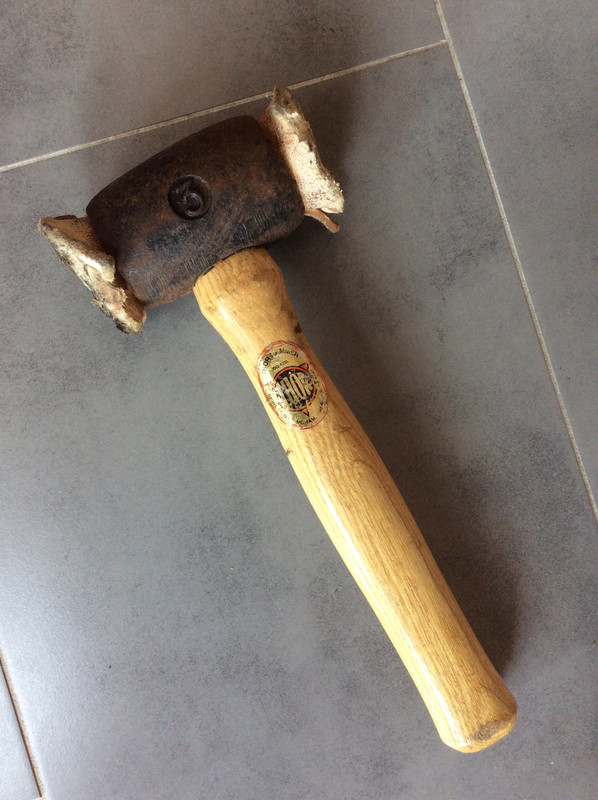

Is there a hardness standard of the chrome....or is the lead in your hammer too hard?....either way im not supprised...bash some chrome with a lead hammer and something has to give.....use a wood spinner protector...or better still get some original spinners and have them rechromed....its not like weve not mentioned before that repros arnt very good......Steve

You may be right Steve, getting a set of originals is the way to go. I’ve always been an advocate for owners to use lead mallets over copper(due to age hardening). I have had motor cycle forks hard chromed not like some of this poor chroming today which marks as if it made of aluminium.

Thats why i questioned the hammer....a genuine lead one is very soft and will deform on the first whack. ....Steve

Agree totally. I cannot see how a mallet that gets marked if I dig in a thumbnail can possibly mark a spinner that certainly doesn’t.
The decorative chrome layer* is super thin and has no structural integrity against hammer blows beyond the strength afforded by the manganese bronze substrate. Other than a hidden casting flaw just below the surface at the point of contact (assuming the spinner blanks weren’t forged) I cannot believe a true soft lead mallet could ever put flats on a spinner. That being the case, something is not what it appears…
*NB a very different process from centreless ground hard chroming of hydraulic rams and fork legs etc.

That looks like grit got into the face of the mallet. At least the pock marks do. Hard to see if there are wavy deformities too, which could be polishing error. How many were affected?

The pock mark was originally there and probably a finishing defect. I have only used the lead mallet on this spinner as now I am reluctant to use it on the rest.

Hi Paul....i would still question your mallet. ....im assumeing that you had standard S2 federal type previously that needed the adaptor tool......so you never bashed 2 ear spinners previously with you mallet.......instead you were hitting the adaptor.....iv seen plenty of mallets on S2 that look like lead but are actually a harder material for hitting the federal spinner adaptor.....A proper lead mallet you should be able to mark with a fingure nail as Peter mentioned above.....Steve

Thanks all for you comments and it’s good to bounce off each other. The Thor lead mallet I use can be marked with my thumbnail and the faces are grit free and only used for ear spinners. With an engineering background and having been in the engineering supply trade for the last 40 odd years, I have amassed every every type of tool, quality hammers or mallets available, I am in the fortunate position to keep specific types for specific purposes. If it is the case that the new spinners are inferior then I will only use the widget with a 1m power bar. I’ll keep you posted.
