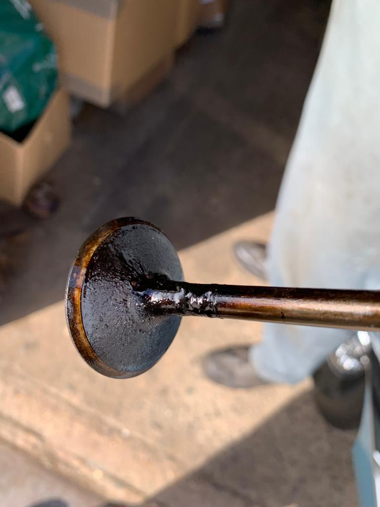

As I seemed unable to resolve my tappet noise, valve clearances all correct, compressions fine and even, I enlisted the help of my local Jaguar Specialist. He has removed the head and found most of the inlet valves were severely gummed up as per the attached photo.
It would appear to be caused by petrol going off. The car has been used regularly but has only covered 1500 miles since the engine was rebuilt four years ago.
I think in future I will be using Suuper unleaded E5 combined with Valvemaster plus
Gutted and a lesson learned
