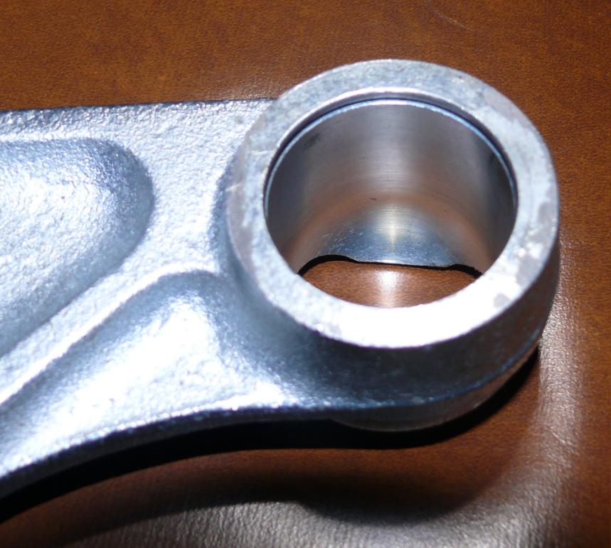

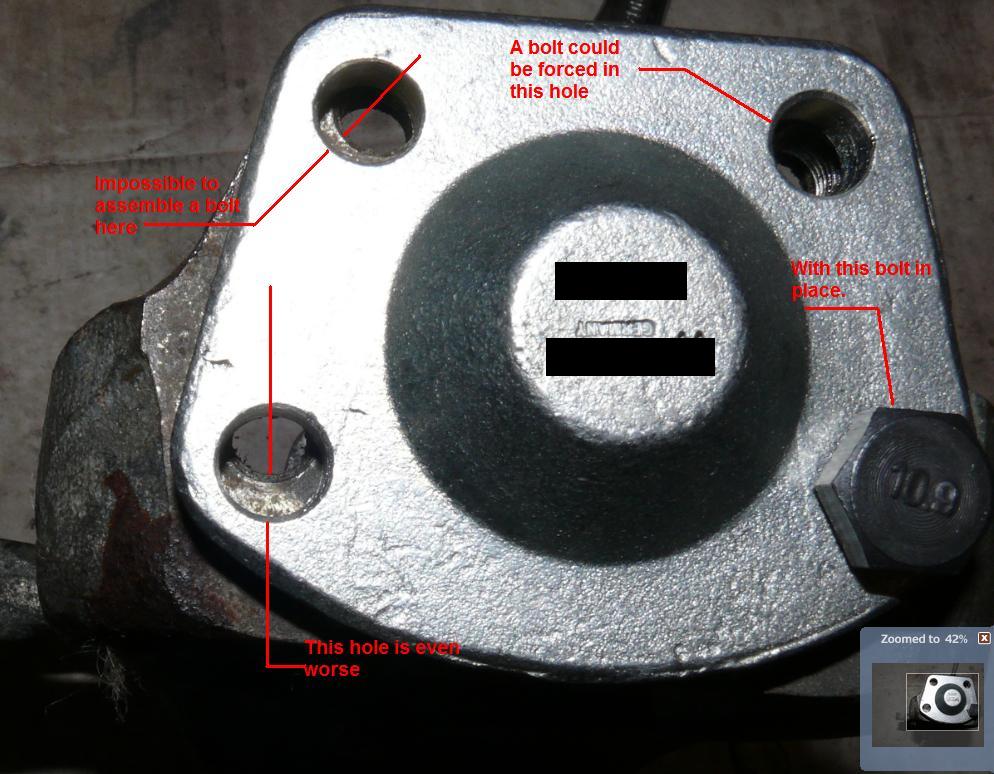

As suggested by others and unless you wanted to retain originality for the lower ball joint, the sealed for life unit is a better proposition. However, there are many manufacturers of these and the only brand to use, in my opinion, is Lamforder. The following picture is of just one defect of an alternate brand sent to me.
With regards to the Top Ball Joint, the Ball Pin Socket is integral with the wishbone and once its worn, the wishbone should be replaced, or repaired (by someone competent to do so). Having the Ball Pin Socket welded, machined and heat-treated is not a simple task, particularly the heat treatment. The material used in the wishbone is a high carbon steel, and therefore, is classed as a through hardening steel. The original specs on the heat-treatment was for a fairly thick, very hard surface case (high 50s RHC) and a tough (not so hard) core. Nitriding and other surface hardening processes will work to achieve the surface hardness, but not the depth specified. Originally, this was achieved via Induction Hardening, but a special shaped heating element is required. I used to do repairs by welding, machining and the correct heat treatment (meeting ALL the specifications) using a correct heating element, but its not a cost effective repair method.

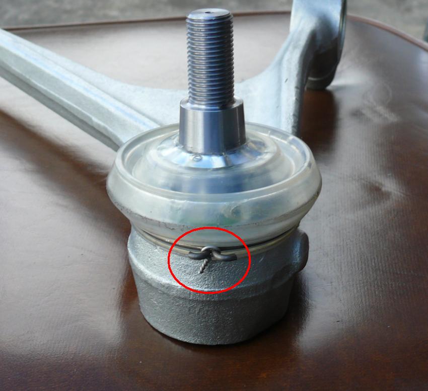

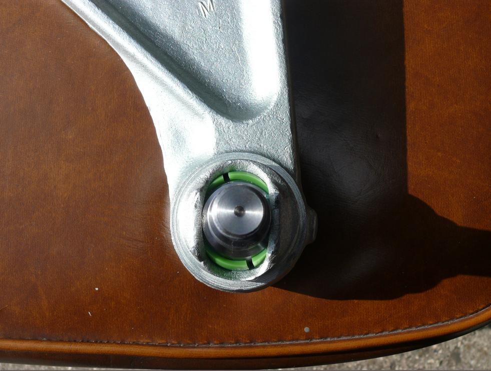

A good method to reclaim worn upper wishbones is via machining and fitting a nylon insert as shown in the following pictures. The last picture showing the method I use to ensure the Dust Gaiter and clip stay in place.
Whichever upper ball joint system you go for, don't fill the Dust Gaiter with grease, as many do. This is to keep dirt and water out, its not a grease reservoir.
