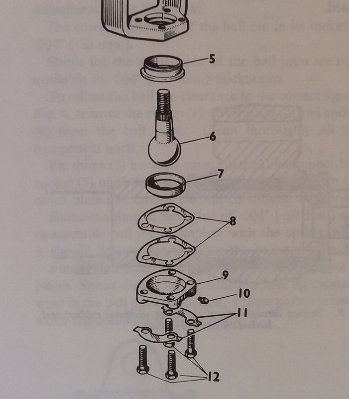

Working my way through the service items , I got to the section for the front suspension in the handbook and noticed the instruction to grease the top and bottom wheel swivels . I did the top one ok , but the bottom ball joint / swivel doesn`t seem to have a grease nipple . Any idea why this might be ?

Hi Mark....not unusual for the bottom ball joint to be changed out for the later xj6 "sealed for life unit".... there are grease nipples on some prop uj,s Service manual details grease every 2500 miles... Steve

Thanks Steve - yes , that would explain it , they also look to be slightly different in that they have a rubber sleeve around the joint that is not present in the diagram . The propshaft UJs will have to wait until I have time to raise the car enough to get underneath .
