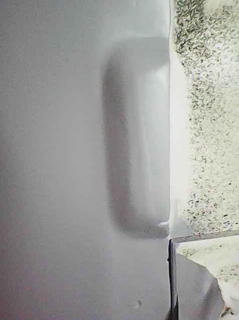

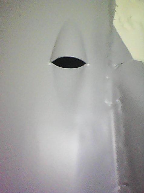

#7 Re: Series 2 Sills
Hello Colin,
Following are pictures of the Front and Rear Drain holes of the sill for an S2 OTS and FHC. The first picture below is of the Front Drain hole.
Both of these are easily formed by hand if they don't exist in the sills you have.

#8 Re: Series 2 Sills
Thanks Bill. That matches one of the ones they sent me, unfortunately not the installed one. A lot easier to form before installation, but we'll get round it!
