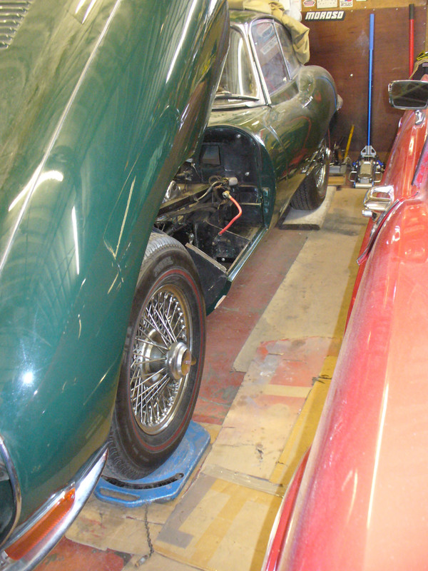

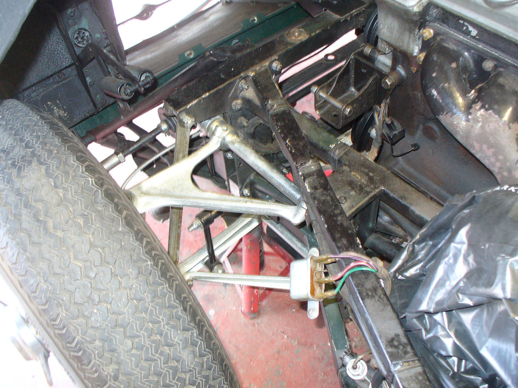

I have the suspension setting tools fixing the front suspension in the mid laden position.
1. Camber comes up as +1/2 degree both sides. Worth removing one more shim?
2. Should I tighten the rubber bushes in the mid laden position as they are now or just on normal ride height?
3. Can you buy a rear suspension setting tool? Ideally would like to borrow one as its just a one off job.

I may drop out another shim. Only an hours works and last chance before the mud shields go back on.
castor is about 2 degrees so happy with that.
Rear tool was to set the rear of the car at mid level to match the front and set the castor but I found a thread that says the sills should be level so I put boards under the rear wheels to level it (have turning plates on the front)
I'll mess around this week and get the tracking closer as well. My little Gunson track right gets me in the right ball park and will shoot for total 1/4 degree (1/8" each side).
