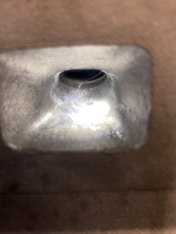

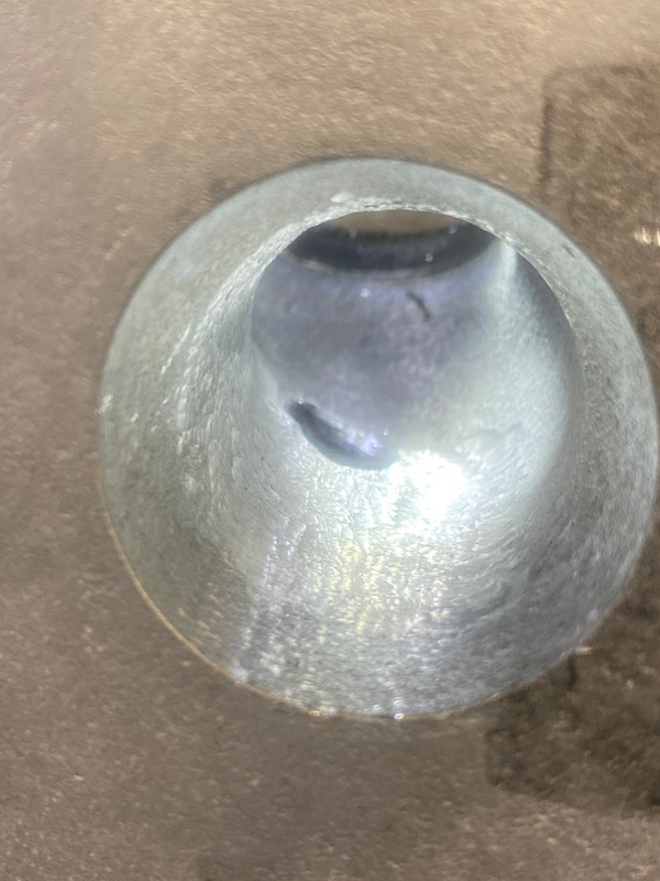

Post by abowie » Fri Oct 22, 2021 5:15 am
Armed with Des Hamill's XK Engine tuning book and a sense of trepidation I have embarked on the head for my MK2.
Brenton my machinist's comment "Nah mate you can't stuff it up."
So I made a brass mandrel punch, heated the head up with the oxy torch and knocked the valve guides back to give some room.
After 3 hours:
inlet and exhaust guide bosses gone
exhaust roof lip relieved
inlet port side waist flattened and opened up a smidge
Exhaust post exit.
Exhaust port throat.
Inlet port entrance.
Inlet port throat.

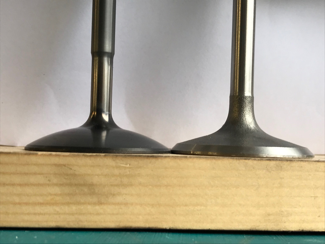

Post by steve3.8 » Sat Oct 23, 2021 3:18 pm
This photo may explain better , these are 1.875" inlets . The REC on the left and a commonly supplied on the right.
