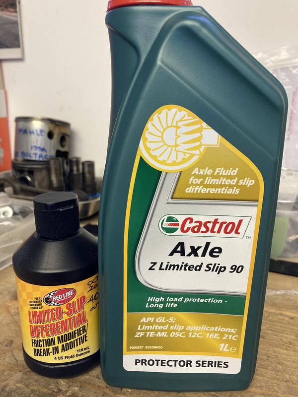

Sorry to be late to the party, but a few comments in response.
With regard to what is the correct oil and service recommendations, you need to look to the actual manufacturers recommendations. Jaguar did not make the Powr-Lok differential and hence a little history is required.
The Powr-Lok was developed in the 1950s by the American Dana Corporation under patents from the Thornton Axle Company. It was manufactured under licence by GKN Salisbury Transmission Limited for European use. This is from the Service Manual from the Spicer Axle Division of the Dana Corporation in Fort Wayne Indiana. Please note the “Important” paragraph below :-
You could use a SAE 90 oil in a Powr-Lok differential, but the limited slip clutch and friction plates would not be working effectively and there would be a high degree of risk of damage to them without a suitable oil either already containing a suitable friction modifier, such as this Castrol oil, or adding said item to standard SAE 90 oil - such as below :-
As regards the original questions, both the non Limited Slip and LSD differentials have breathers. The action of the Powr-Lok differential is to effectively lock both sides of the output shafts, hence why when the car is jacked up, both wheels will rotate in the same direction. It is when the car turns a corner or one output shaft moves differently to the other that the clutch plates need to operate and without the correct friction in the oil they are not effective and can give rise to chatter. This is especially true when a axle is rebuilt and the various clutch and friction plates need to “bed in”. Regarding the axle noises, this would not be a result of the LSD components and much more likely to be originating from incorrect meshing of the drive gear and pinion, or from bearings on the differential or pinion shafts developing play. No oil additive is really going to sort those sort of issues, other than inspecting the axle to track the actual cause.
I trust this assists.
Dave
