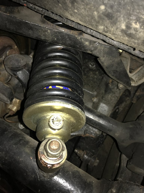

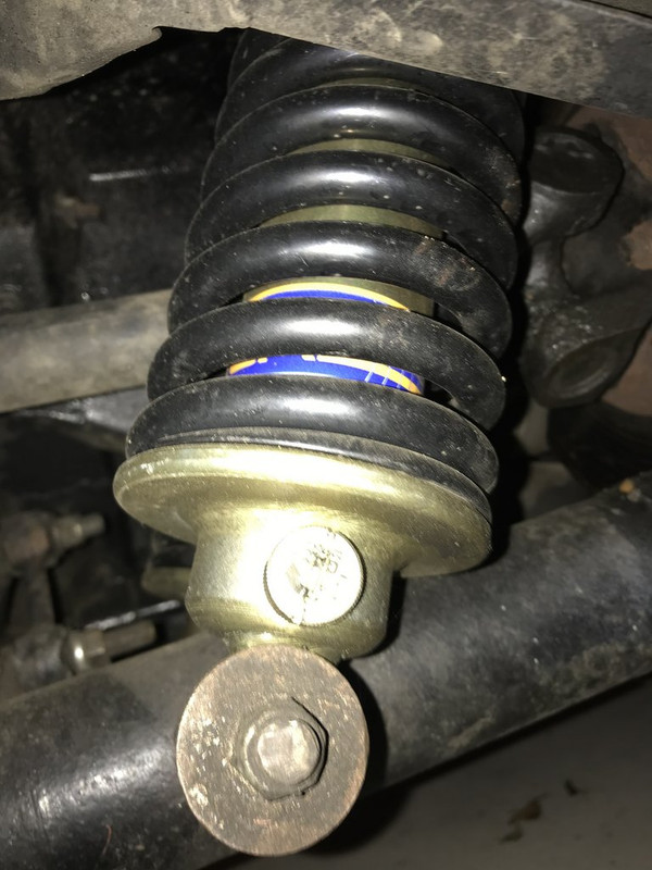

Hi, the previous owner of my car fitted new rear shocks just over a year ago and the ride height seems too low to me, with the top of the rear wheel arch in line with the top of the wire wheel. Most pics of similar cars seem to have an inch or two of tyre showing above the wheel at the rear.
The new shocks are Gaz and they appear to have adjustable damping. Can anyone identify the specific shocks and advise if they have adjustable platforms to vary ride height or if it would be a case of buying longer springs to achieve this?

Hi Darryl.....your shocks do not look adjustable for height......looks like you also possibly have new springs....what tyres are you useing as this also affects ride height......far better to measure your height from the irs bottom plate to ground rather than useing rear wings that could have been altered over the years.....spacers are available to fit between spring and damper to raise the car......plenty of info on ride height in similar topics shown below....Steve

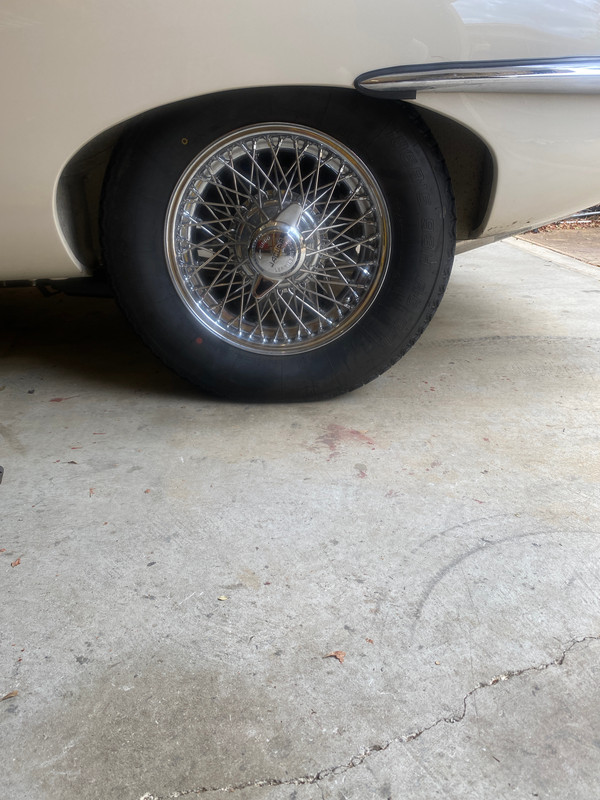

Hi Steve, i think you’re right that they’re not height adjustable, and the springs do indeed look new. I’ll do some proper measurements front and back when we can get it onto a four poster. And I’ll have a rummage through the other posts on this topic. Here’s a pic of the car that shows the rather low ride height. Looks like it has lead from the church roof in the boot :bigrin:

Without being an expert, I must say that looks low. It's not just the height, but the angle of the car - front up.

That’s what i think too Malcolm. I’ve already grounded the exhaust on some loose gravel, a sleeping policeman would take the thing off :sad:

The adjustable-perch GAZ dampers use a different size spring AFAIK. Yours may be different?
