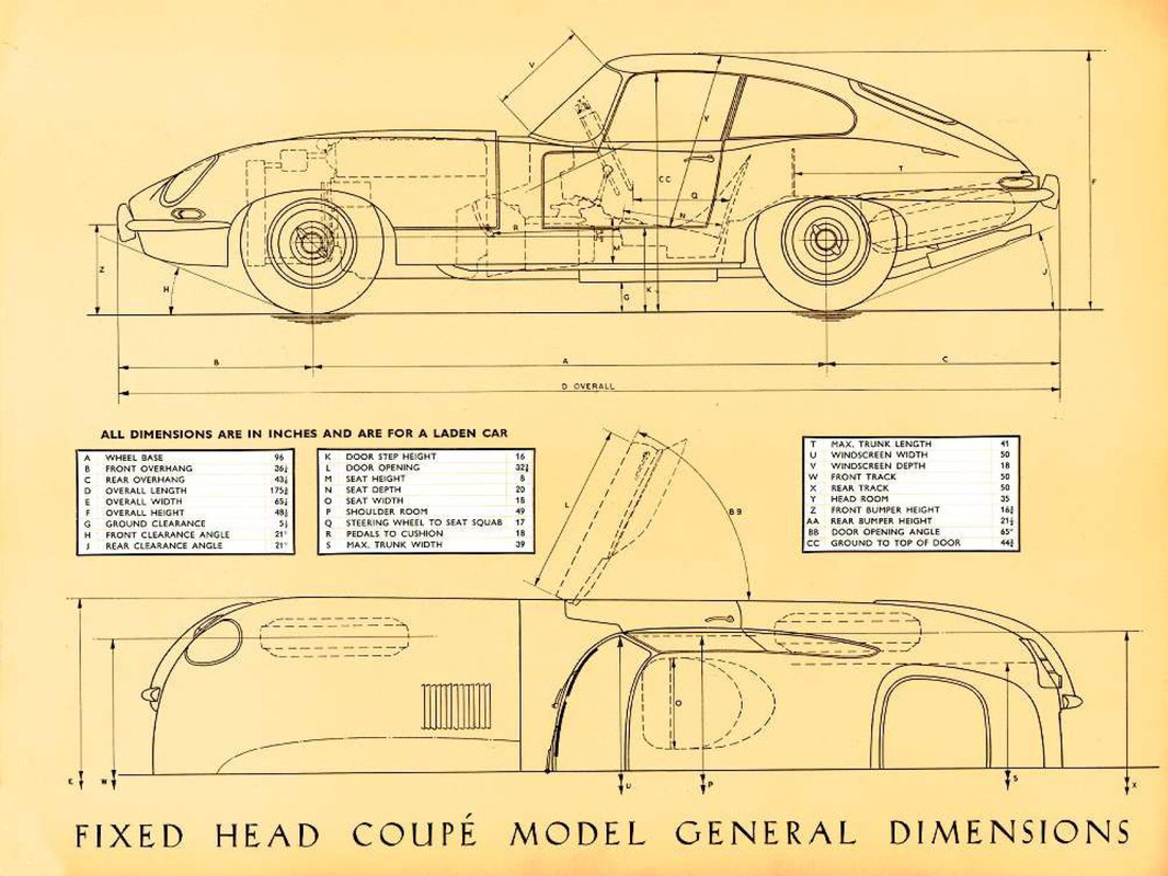

#21 Re: Identifying shocks and ride height
Given different spring rates, tyre heights etc, the following diagram from the original 1961 brochure may assist:
NB all dimensions were shown for a laden car (not sure what is meant by laden - Driver and Passenger & full fuel tank?)
The Front (16.75 inches) / Rear Bumper height (21.5 inches) are of particular note as is the ground clearance expected under the mid-point silencer (5.5 inches) What is of interest (given this thread) is that a laden car would have the rear wheel arch aligned with the wheel rim.
1964 S1 3.8 OTS
1964 S1 3.8 OTS
#22 Re: Identifying shocks and ride height
Hi Phil.....front/rear bumper height is different in the diagram....not the same.....Steve
#23 Re: Identifying shocks and ride height
I definitely don’t have 5.5” ground clearance but that could be down to the way the exhaust has been fitted. I will have a look at overall height (when I’m back in UK) as this could be a useful indicator.
Darryl
#24 Re: Identifying shocks and ride height

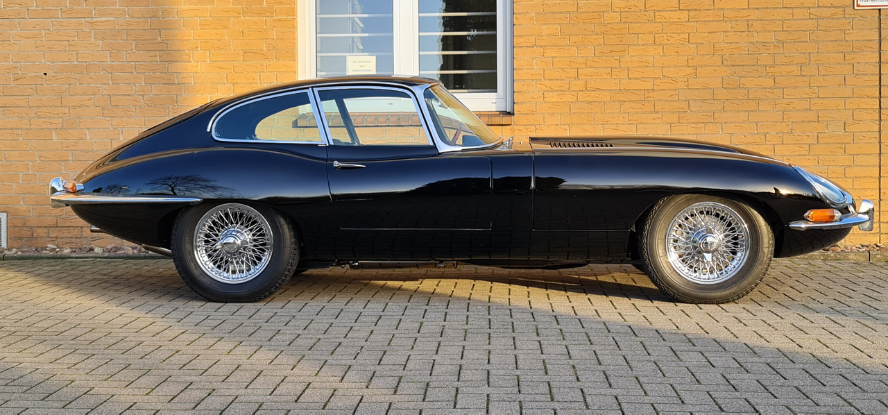

Yes, I spotted that too but only after my original post (I've now updated that). The photo below (from the Technical Descriptions and Specifications booklet) clearly highlights the degree of difference
If the ride height figures were supposed to be with the car laden, it makes you wonder if there were weights present in the boot of the car when the photos were taken thereby forcing the rear wheel rims to be level with the wheel arch (as per the sales brochure dimensions diagram above).
1964 S1 3.8 OTS
1964 S1 3.8 OTS

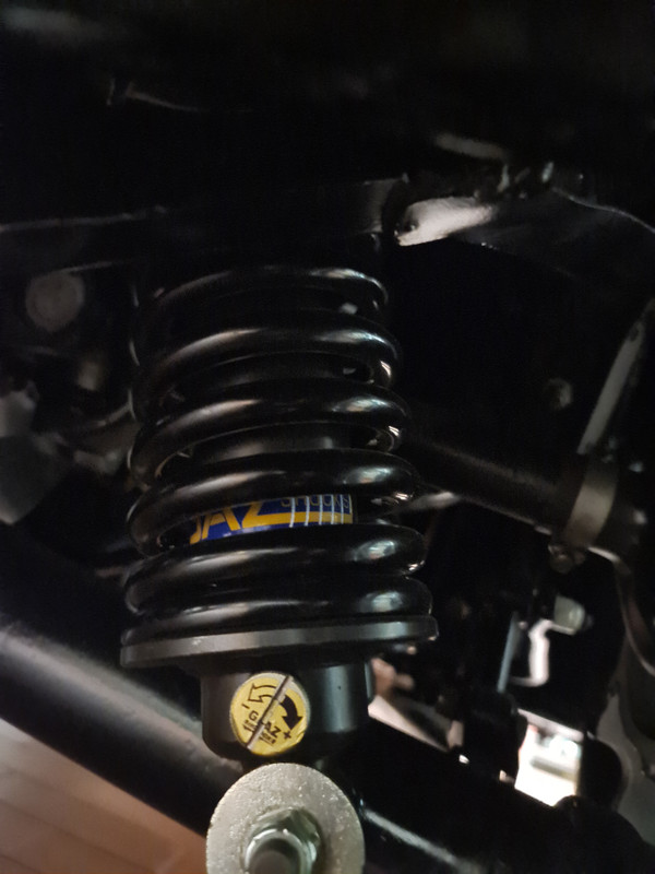

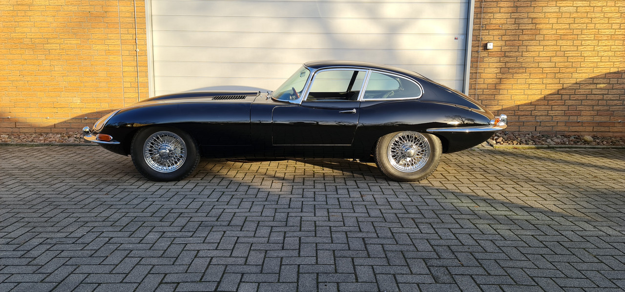

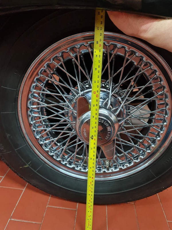

Right time to join the topic,
I also have the same GAZ newly installed. With standard tires and 15" wheel the top of the rim measured from ground level is 53 cm, the wheel arcs measure 55.5 from the ground.
So it is about 2.5 cm gap. Equal on both sides
At the front I have 22.5 cm as measured and indicated at the workshop manual
Still it appears rhe car is sitting slightly low at the rear.
I do not want to lower at the front as the exhaust clearance is already just below 5". Might be an issue of the exhaust.
Who can confirm either of the measurements?

Hi Maikel that’s helpful information. I’ve just checked the measurements on my car against yours. Your figures in brackets:
Rear wheel - ground to top of rim 52cm (52.5-53)
Ground to top rear wheel arch 52.5cm (55)
Front - ground to torsion bar centre 19cm (22.5)
Ground to bottom of IRS carrier 17.2cm - thats about 6.75” and i believe i read somewhere it should be over 8”.
I’m thinking my ride height is about 3-4cms too low. I’m wondering whether Gaz do a longer spring length for their adjustable fixed platform shocks. I’ll give them a call.

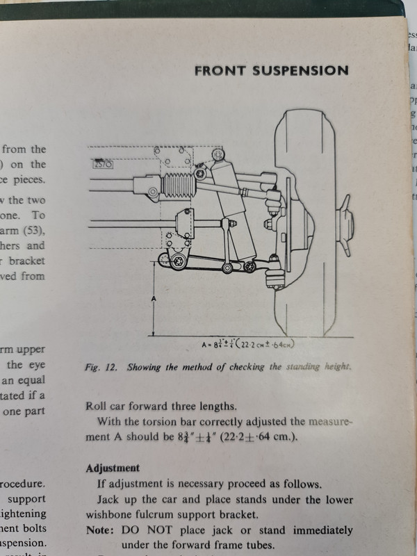

Hi Darryl,
so your rear seems to be about 1 cm lower than my what could be a tire issue. I have the Michelin 185x15 and 2 bar pressure.
But also the gap between your rim and wheel arch is too small according to me.
What surprises me even more.
You say, the center of your torsion bar is 19 cm from ground, which seems to bee extremely low.
The 22.5 cm on my car are measured from the center of the lower wishbone shaft according to the picture , the torsion bar should be just a bit above.
Having said that, you would have to raise your front even more which would just be the opposite of what you are after.
It seems, you really need to get other rear coils, but your front is too low as well.
I have done 2 miles in my car and I am a bit reluctant to lower the front on my car as it might still drop a little bit due to the new bushes at the front suspension. So maybe some railway's or curves will drop it.
I might wait with lifting the rear end on my car.
Keep me tuned.
Maikel
Keep me tuned.
Maikel

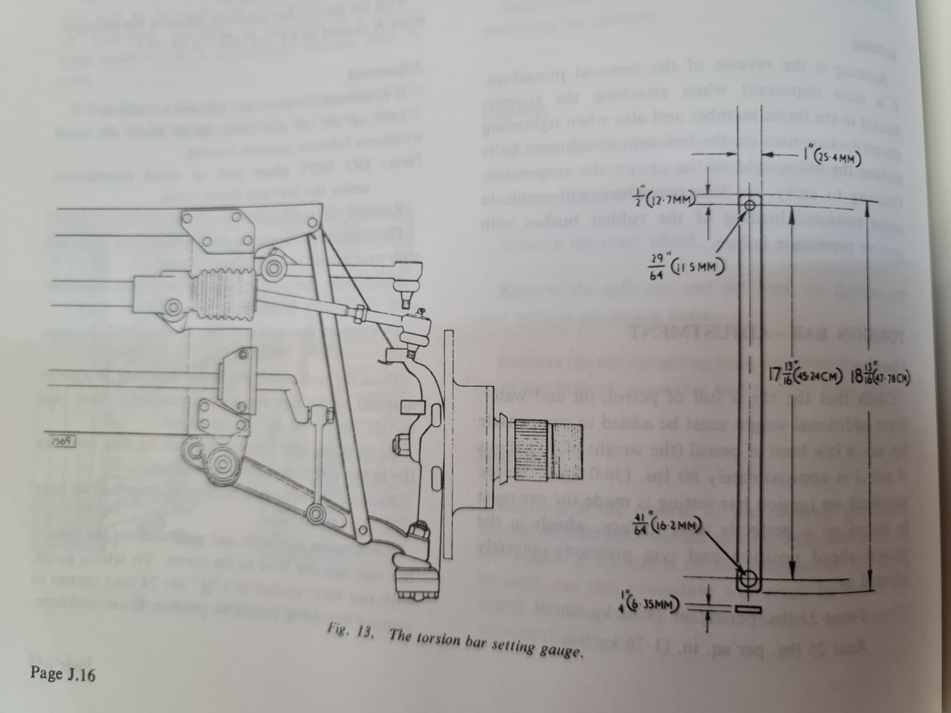

#32 Re: Identifying shocks and ride height
I took the picture of a later green workshop manual, I also found another drawing where you had to deduct height B from Height A and it was as gap of 16 mm +/- something, but that was in an earlier workshop manual.
So, you are saying there are 3 different heights or ways to measure the torsion bar adjustment?
I was also wondering,
When you mount higher springs or install spacers, do you get more ground clearance between IRS cover plate, do you increase the gap between rim and wheel arch or both?
#33 Re: Identifying shocks and ride height
Hi Maikel......no not 3 different ways to measure the height. .......there are different heights for different models....there are setting links used to set front ride height.....different setting link dimensions for different models........Re the rear....when you add spacers or fit taller/ stiffer springs you raise the irs/body.....so you get more ground clearance and more gap between rim and wheel arch.....Steve
#34 Re: Identifying shocks and ride height
Maikel, did you buy new springs from Gaz with the Gaz dampers? If so do you have details of their specification?
Darryl
Darryl
Darryl

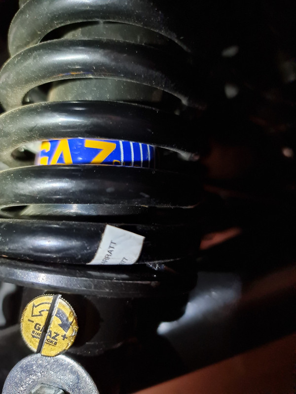

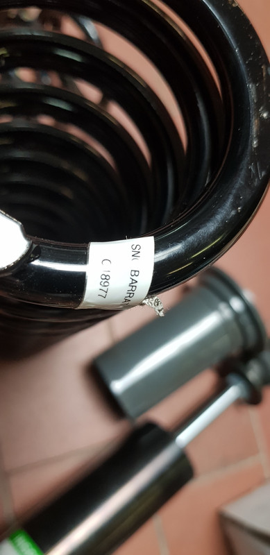

#35 Re: Identifying shocks and ride height
@Steve
I am aware that early, later and 2+2 do all have a different front torsion bar setting tool. They vary slightly. But I also know that when using this setting tool it does not mean your front ride height will stay correct.
I had that with one of my cars, but worn torsion bars resulted in a dropping front height.
So even using the correct setting tool we all know that the below distance is not always correct.
So, what are we after? The setting tool distance or the exact ride height at the front?
However
I do have 22.5 cm at the center of the lower wishbone shaft which is in the tolerance of 22.2 +/- 0.64 cm.
And here are pics of my delivery from SNG
I have been told I would not need any spacer.
Just the springs and dampers.
I think now I still need those spacers or longer springs.
Maybe spring C18977 is to short, or even wrong.
I have some 11 mm spacers which I will now install and that might help to get more ground clearance at the IRS plate and balance the car front-rear height.
However

What's important about ride height is that the exhaust doesn't hit the ground when you go over a bump. Those spacers should give you around an extra inch at the rear.
As an aside if you look at the SNGB website (as an example, not being critical) they list C18977 as the same part as C25939 and say that it's suitable for all of the cars below, even though they have different part numbers.

I just had a chat with SNGB. They say the standard springs C25939 will fit the adjustable Gaz dampers (fixed platform) and that they are 11” (28cm) long and have a spring rate of 270lbs.
The Gaz springs sold by SNGB come in 2 flavours, 275 and 325lbs, and are both 8”.
If i have the Gaz 8” 275lbs springs ( i need to check this) and i replaced them with the standard 11” 270lbs springs would the approx increase in ride height be 1.5” ?
