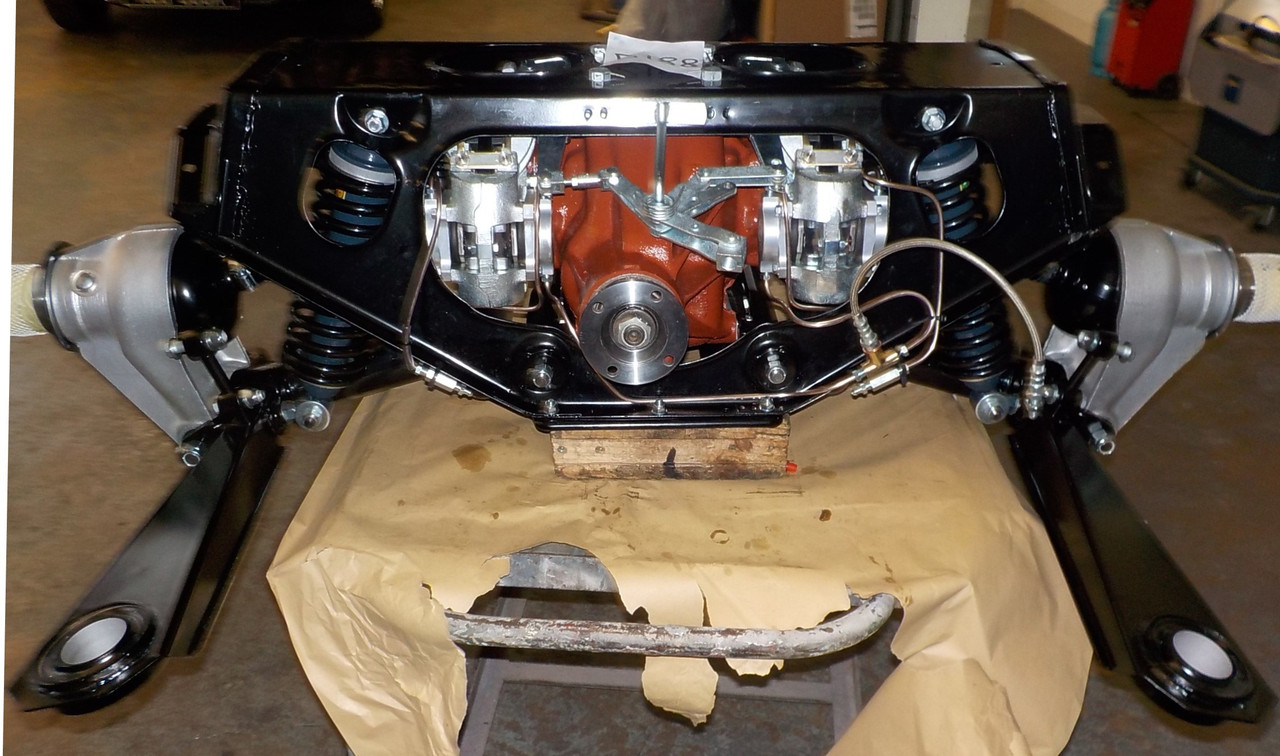

I’m currently restoring my IRS at the moment and doing a vented disc conversion. I’m the best part of £1500 for parts, paint and plating. £550 of that was for the shocks alone, which are also on a 8 week lead time at the moment, £200 for the disc conversion too. FYI - Shims for the diff output bearings from SNG are on back order too, due in Jan, but I made some at work.
The refurbishment is actually a very easy job to do, it just takes a lot of time. The endless amounts of cleaning is the worst part! Factor in a rear brake bleeding kit and see if your if prop shaft needs work too - UJs for mine were less than £30 but the tiny rubber dust boot was eye watering for what it is!
