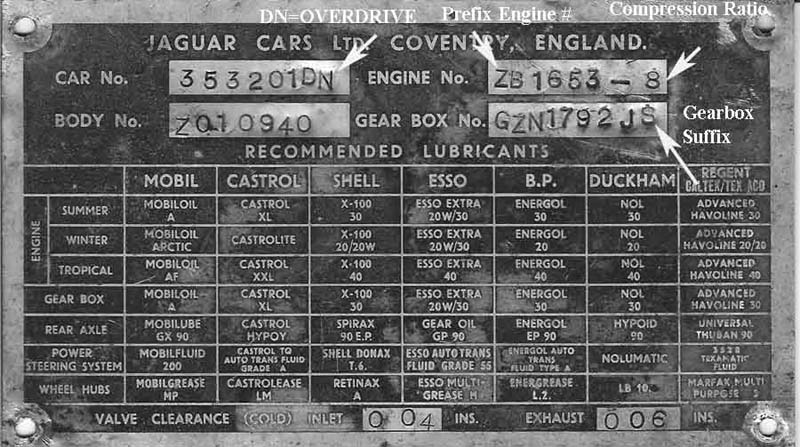

#5 Re: Engine plate stampings
Post by skodajag » Fri Dec 10, 2021 8:42 am
This was the photo which misled me, although looking more closely it’s only a few digits which seem to stand proud:
https://sites.google.com/site/jagxk150/ ... edirects=0
Jonathan
Series 2 FHC, 1968
Posts: 9226
#6 Re: Engine plate stampings
Post by mgcjag » Fri Dec 10, 2021 9:13 am
Link dosnt work.....just post the photo.....Steve

Posts: 15203
#9 Re: Engine plate stampings
Post by Heuer » Fri Dec 10, 2021 3:52 pm
Here you go. Link works for me with no need to download.
2026 Lexus LBX
Posts: 9226
#10 Re: Engine plate stampings
Post by mgcjag » Fri Dec 10, 2021 4:38 pm
Thats a Mk 10 plate......not E type. .....Steve
