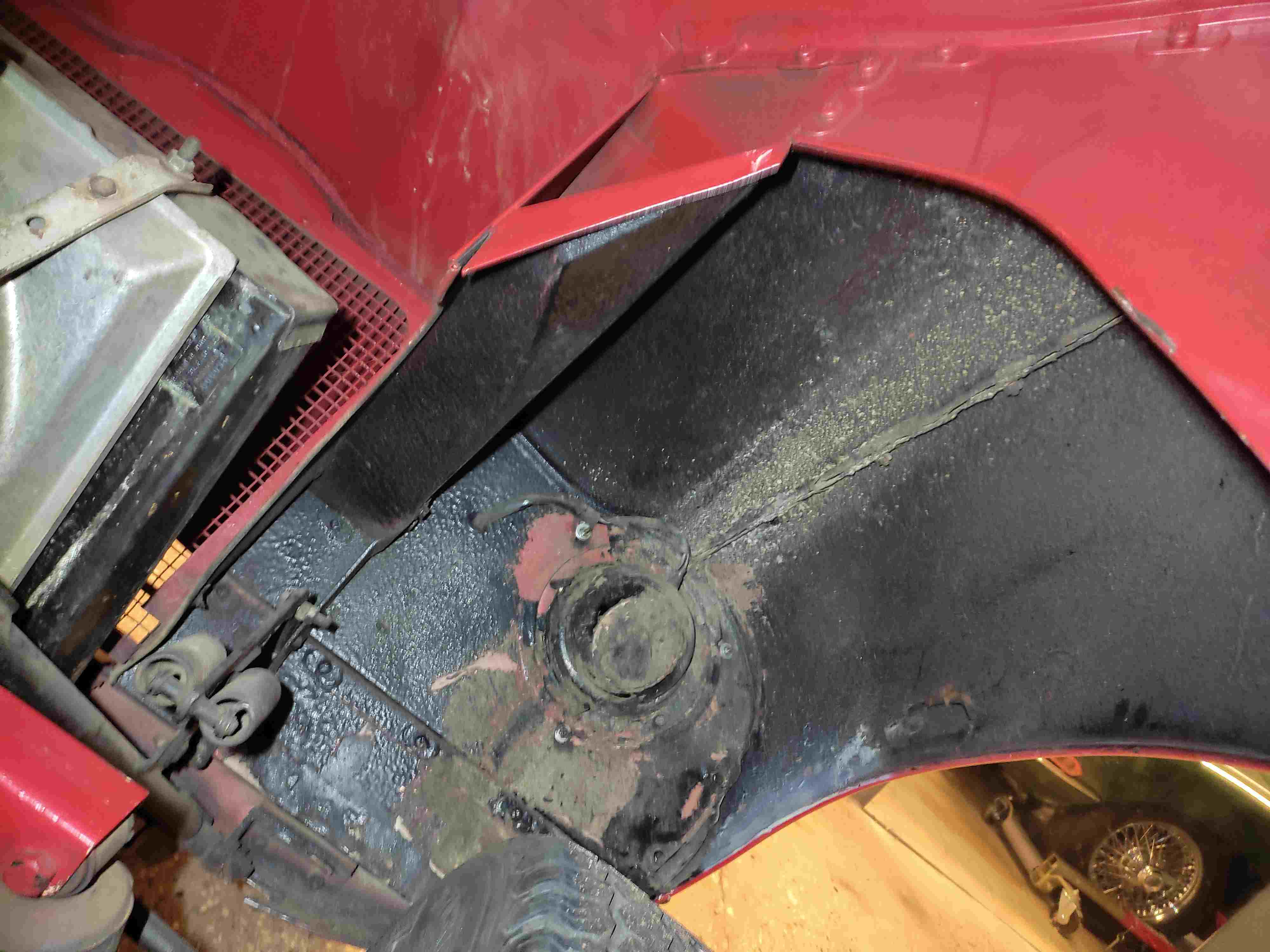

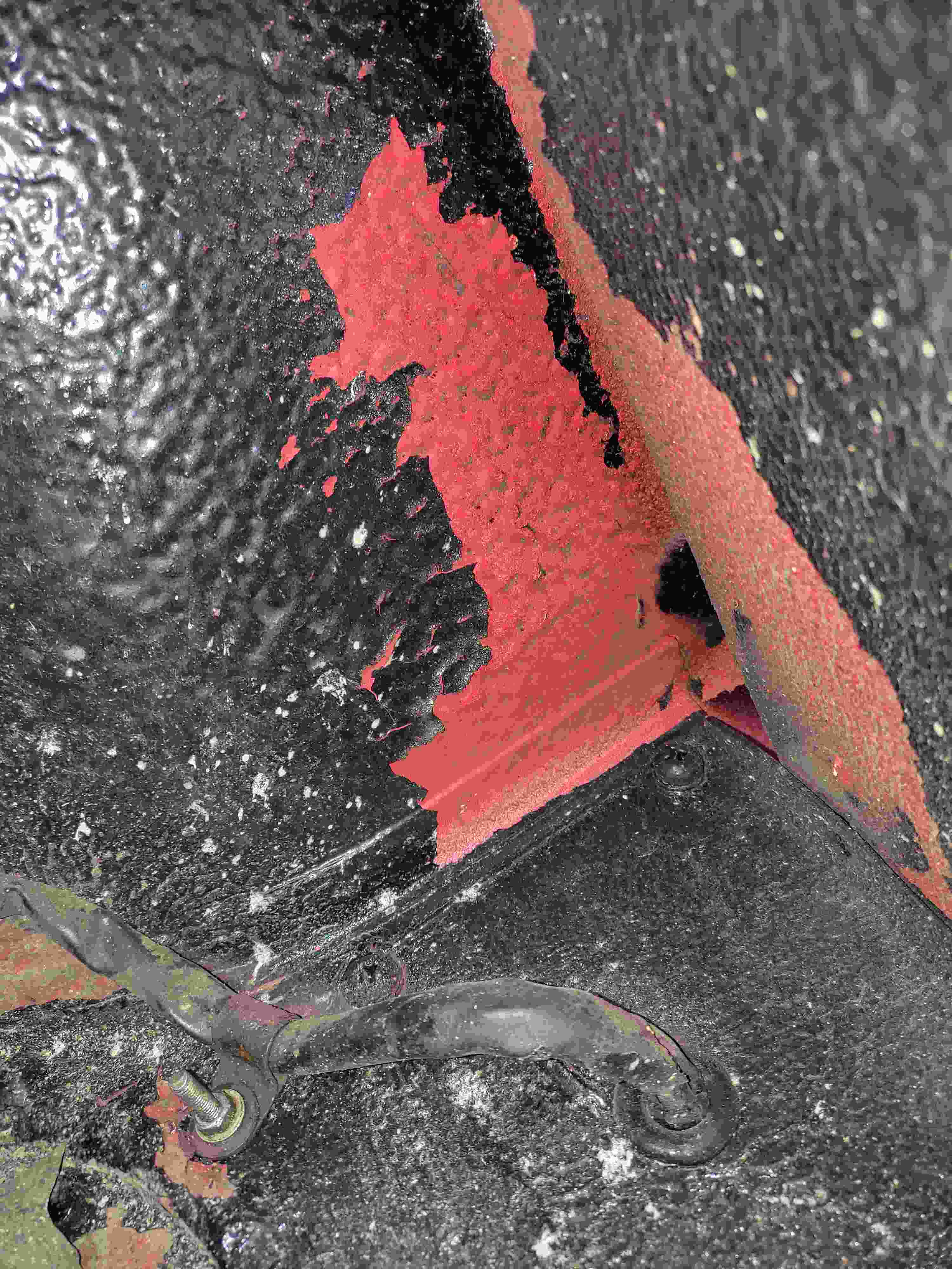

Post by paydase » Thu Feb 23, 2023 11:25 pm
The bonnet of my car was resprayed sometime in the past, and that included a respray of the underbonnet and a black protective coating under the wheel arches.
It was not a top quality job and the black coating appears to chip under use, revealing what I think was the original treatment, which was apparently some kind of tar coating with an overspray of red:
As it stands, not only it is not very nice, but worse it does not protect anymore from possible water ingress and therefore corrosion and possible dents.
I will have the protection redone as original, all in red.
Serge
