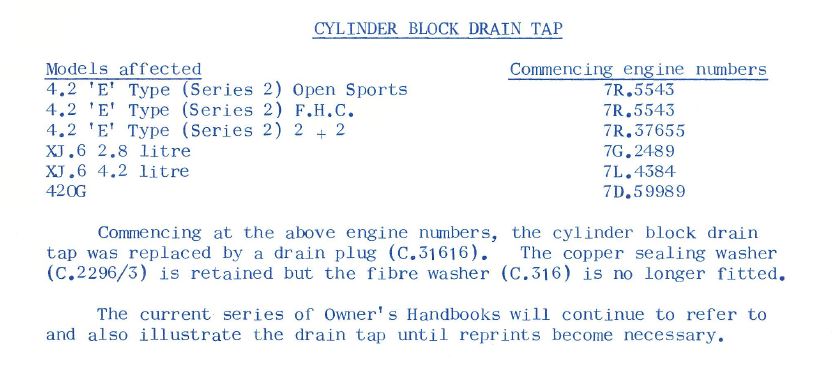

Hi Mark........yes a drain bolt replaced the drain tap....not sure when......engine numbers on engine above the oil houseing then later changed to being on the egde of the block next to the dipstick where the bellhouseing mates to it....Steve

The drain tap was replaced with a "drain plug" (C31616) as per Service Bulletin B.69 (published in June 1969). Once you've identified your engine number, those quoted below should be of assistance
