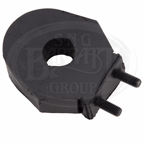

The much-debated rear-bump-stop rubbers are asymmetrical, i.e. you can have them leaning inwards or outwards.
Can somebody tell me which is the correct orientation, please ?
And also how they know ?!

Can you post a pic of what you’ve got, as I don’t remember mine being asymmetrical - but it was along time ago so I may be wrong.
The rubber stops on the SNG site look symmetrical to me but that may just be the angle of the picture.

Hi Rory....without a car in front of me I think I remember fitting these tilting outboard at the bottom...tilting inboard they cant make contact with the hub...but I may be imaging it....Steve

This is S3 but AFAIK same applies for earlier models.
Inward facing
Outward facing
Bob

That’s exactly what I’d hoped for, that drawing, Bob.
I know loads of people never fit them or even cut the mounting brackets off, but as I am running skinny original tyres and have no clearance issues I’d like to fit them, and correctly.
