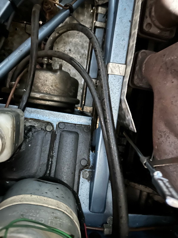

I had the coolant pump belt come off my S1 fhc yesterday, I suddenly noticed the coolant temp at max, so pulled over at the first safe spot and found coolant pouring from the coolant overflow pipe (so it hopefully hadn't been overheating that long or all the coolant would already have gone). I found the alternator/water pump belt coiled up around the alternator, in once piece but one portion stripped of the inner W belt profile. I bought the car last year and hadn't replaced the belt, I'd only inspected it visually, but the alternator and water pump both spin freely, so I suspect it was just needing replacement and I hadn't seen the signs. Recovered the car fine but very disappointed and now quite concerned about the state of the engine.
The oil pressure seems normal, there is no sign of mayo on the dipstick of the oil cap, nor anything in the coolant tank. There is however some abnormal signs of oil from the cam covers. Spattering of oil onto the brake servo pipes on the left, plus a little bit of oil below the cam covers on the inlet manifold. What are your thoughts on this? Excess oil pressure has pushed that oil out of the cam covers, what other likely issues arising?

First check would be the engine breather ..a round fitting on the front of the head....there is a mesh filter in there and check the attached hoses. ......clean everything up then start up and look for where the oil is leaking.....could easily be the cam cover gaskets or very common the cam oil feed pipes at the rear of the head.....Steve

I would naturally replace the belt and replenish the cooling system then wipe the splatters of oil and start the engine looking out for no further overheating etc'. If the cam covers remain dry, I would't worry too much as it is possible that the high temp just caused the oil to be thinner or some expansion thus oil coming out. If the opposite is true and the cam cover seal has broken down then it will obviously need replacing.

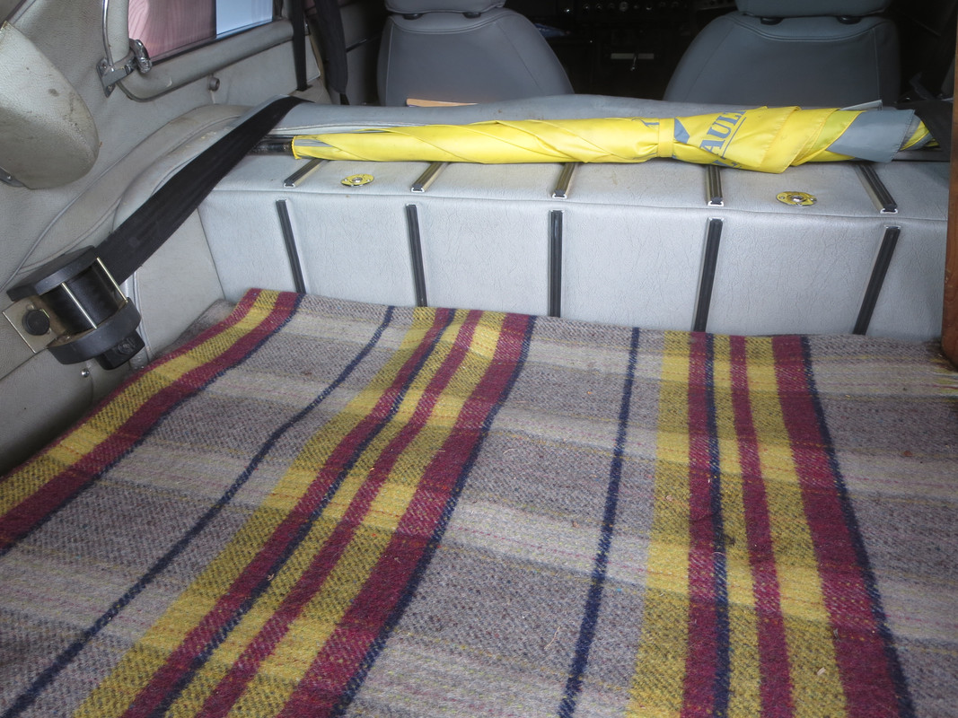

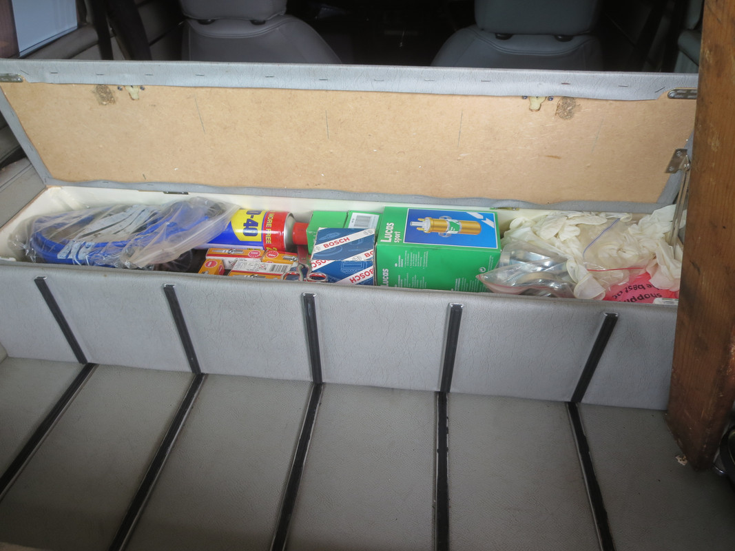

Post by chrisfell » Tue Jul 11, 2023 9:37 am
"Chris, what other spares do you tend to carry?"
This useful little storage box was cobbled up from 6mm MDF and covered with vinyl etc from Woolies.
Inside are a tool box, disposable gloves and paper towels, can of WD40, two warning triangles, plus:
Coil
Plugs
HT leads
Dizzie cap and rotor arm (123)
Lucas rotor arm.
Bulbs.
Hoses and clamps.
In the spare wheel well:
Spare wheel and tyre.
Another inner tube.
Tyre irons.
Electric jack
Scissor jack
Two hardwood pads, for the jack on soft ground.
Tow rope
Jump leads
2l bottle of engine oil
1l bottle of brake/clutch fluid.
When I'm touring I'll add electrical bits too, wire terminals pliers/crimpers, and a few other Spares like a fuel pump, and a brake warning light switch.
The only times I've known any engines to need emergency engine oil, the need has been for gallons not 2 litres. 1st was an early V12 which had a broken pressure warning light switch, the 2nd was a XK 150 whose oil bypass hoses had perished. Both engines emptied their sumps surprisingly quickly. My own need is only when I go on long trips. 1 litre gets used in 1000 miles, mostly dripping rather than burning.
I carry a spare Lucas rotor arm and a selection of hoses more to help other owners than myself.
