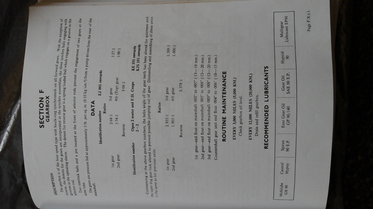

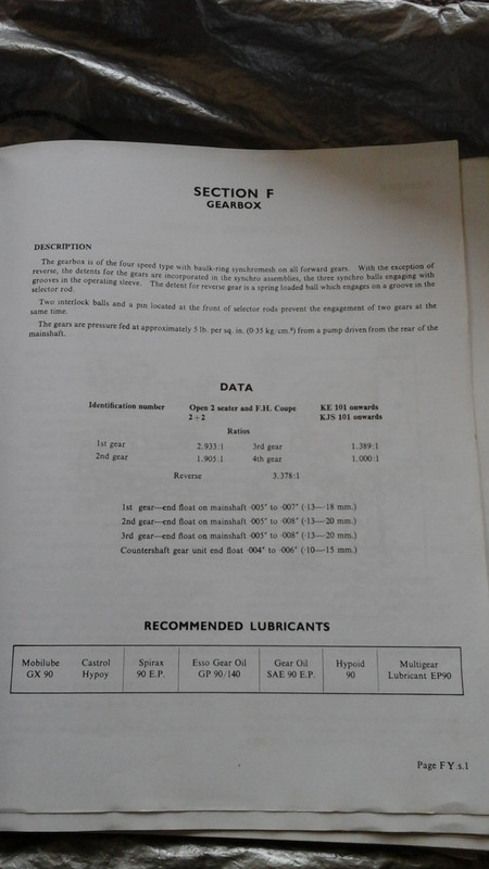

Hi Marcel.....i dont know enough to give specific info see both pages below for 4 syncro box,s(service manual).....first photo gives S1 details and a gear and teeth change for quietness.....second photo S2
