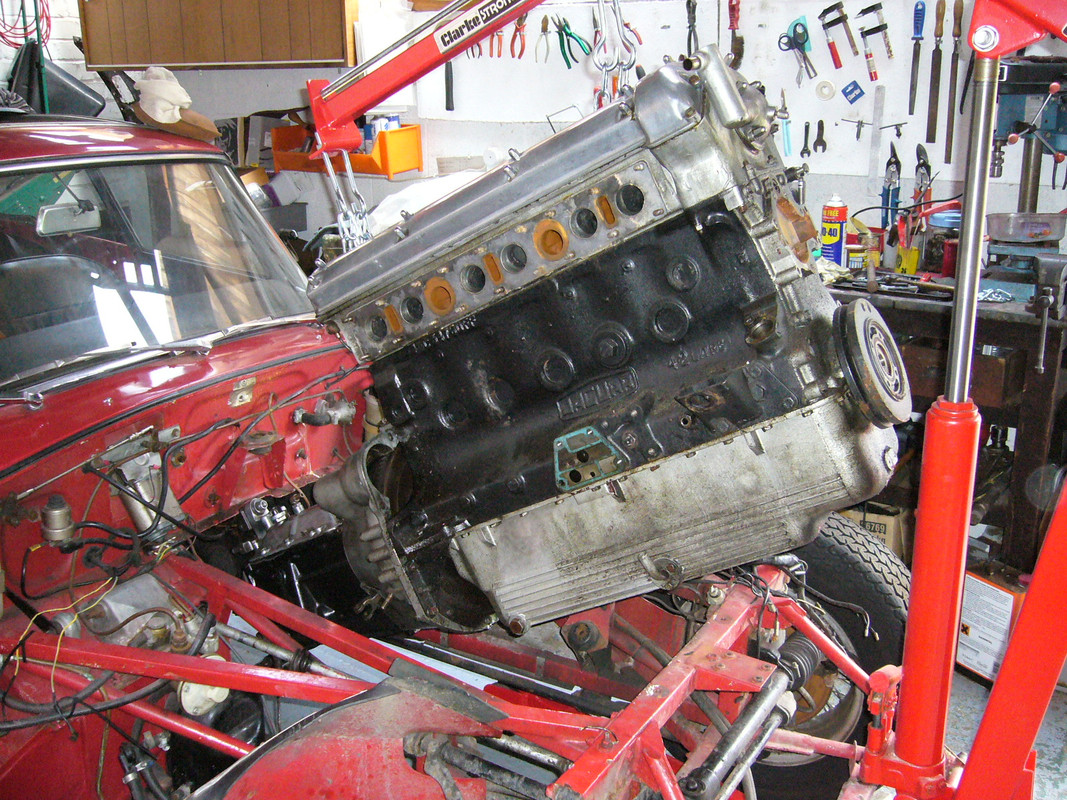

#13 Re: Removing engine
Post by christopher storey » Tue Mar 15, 2022 4:35 pm
Just to illustrate the point of the angle needed to remove the engine and box upwards, I attach a photo
It is self -evident that to use the other method of dropping it all downwards, the reaction plate has to come off because it lies about half way up that gap between bellhousing and sump

#17 Re: Removing engine
Post by angelw » Wed Mar 16, 2022 10:18 am
Jerome Wrote:
but your subsequent picture is pretty accurate to what is needed and there is no need to have fingers anywhere at all risky, let alone near the reaction plate.
Christopher's picture is typical of engine removal from the top, with the Reaction Plate removed. I suspect the injury prone part of removal of the engine with the Reaction Plate in place, that Christopher is referring to, is when trying to clear the engine and gearbox of the Reaction Plate. Where the engine is in the picture is well past that point.
