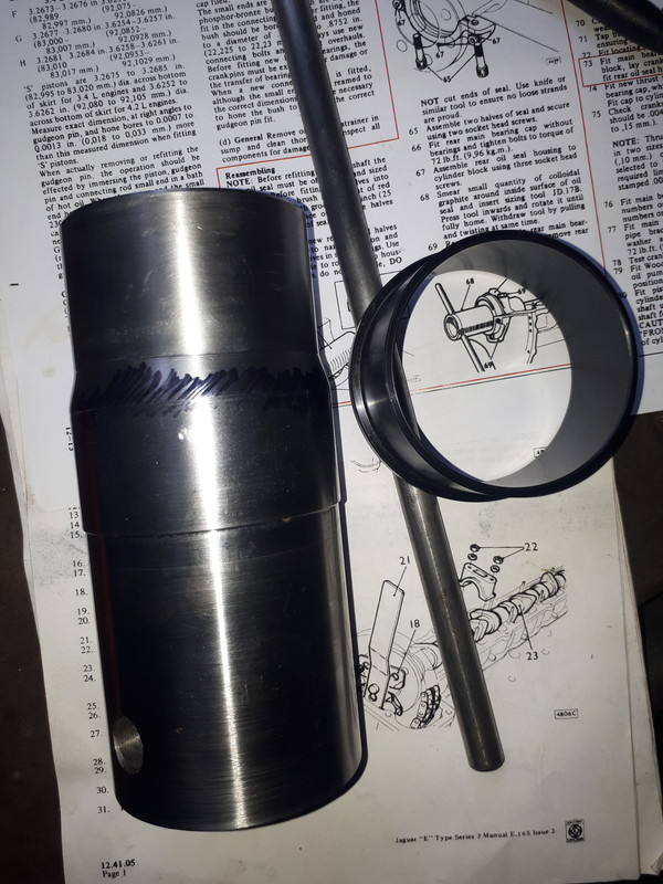

Post by lowact » Thu Apr 07, 2022 2:13 pm
For S3 there is the tool JD17B and the adapter JD17B-1 to accommodate the larger bearings, i.e.
If you try intuitively, the larger setting diameter of the tool is stopped short of the seal groove by the adapter.
The only other way would allow the tool to set the seal except the adapter is not restrained, what am I missing?
https://youtube.com/shorts/YAqKM7sMQPg
Hello Colin,
I made my own where the end of the sizing tool locates in the next Main Bearing Housing along. Doesn't the adapter of your unit, assuming its the same spec as the factory device, do the same?

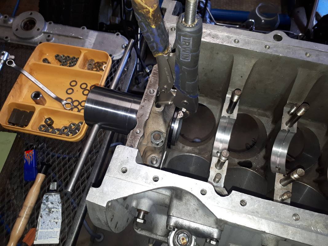

Hello Colin,
Having watched your video again, having the flange of the adapter to left, just about has the sizing tool move towards the left far enough to size the seal. With the bearing cap in place, the flange doesn't have to be hard up against the face of the bearing housing. The guidance of the sizing tool wouldn't be degraded by there being a gap between the face of the flange and the left face of the bearing housing.

Post by lowact » Fri Apr 08, 2022 8:36 am
Thanks. This is how I did it, using a pair of multi-grips to restrain the adapter, to stop if from being pushed out by the tool. Hope its ok, is hard to imagine that this was the intended way to apply this tool.
Andrew, Bill, a v12 tool that doesn't have an adapter, I guess you must use it with the bearing shells installed, so that the tool's bearing journal is smaller than its seal journal?
