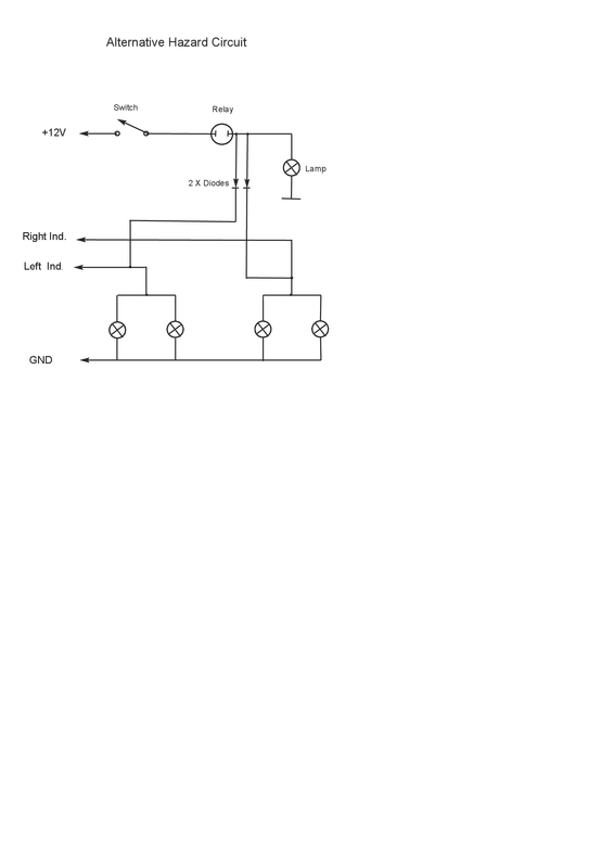

I came up with this simple design, it is cheap to build and I think it will work jus fine. Going to try it soon,

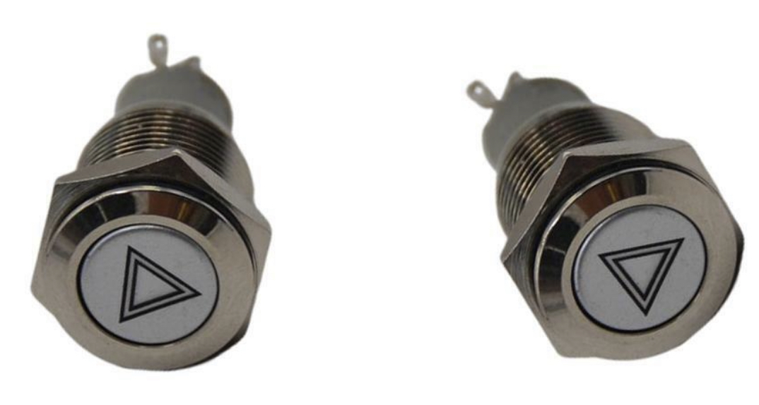

I’m interested in a simple solution and have been toying with similar idea. The relays can be purchased through better car lighting that will do both LED & filament bulbs. I was hoping to incorporate this type of switch onto my existing fan override panel rather than the larger and not very fitting switches that some offer. Negates the need for separate light also as the warning triangle illuminates.
