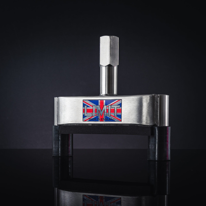

This is the first time that I’ve owned a classic and one with knock off wheel spinners. I am concerned that having no experience with these in the event of having to remove the wheel, can I do it competently and safely. I do not fancy using a soft hammer in case I hit the paintwork in the process. I am a little clumsy with this type of thing. I’ve bought a removal tool from Limit Engineering as pictured and I plan to buy a cheap torque wrench to put in the spare wheel recess along with the Jack and spinner tool. I’ve heard different opinions on how tight the spinners should be fitted. My question is this, is there such a thing of a torque setting I should be aiming for. Do these thing ever come loose?

What do they look like?
Anyone have a pict?
So that Limit Eng tool just puts the pegs on either side of the knock off ears and turn with wrench?
Does it work well?

#9 Re: Knock off Wheel Spinners
Post by mgcjag » Sun May 01, 2022 3:15 pm
Video clip here.....think you will need the impact hammer looking at the design....will be awkward applying pressure with the extension shaft comming out of the tool......Steve https://shop.limitfabrications.co.uk/?p ... inner-tool

Post by mtnjag » Sun May 01, 2022 3:38 pm
Yes, funny the video shows it with an impact. On the road is where it would be most helpful. Be good to have an "on the road" simulation of it in action without an impact.

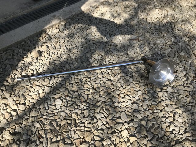

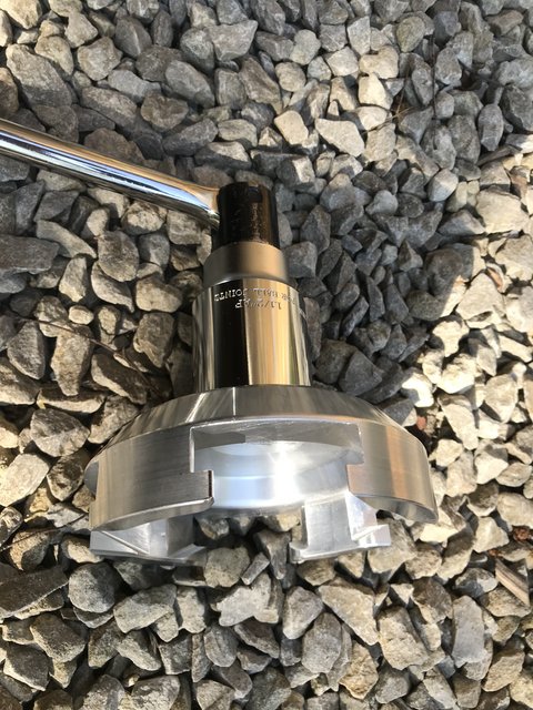

dlgis
Posts: 476
Location: Kent
#18 Re: Knock off Wheel Spinners
Post by dlgis » Wed May 04, 2022 7:41 pm
Just to say Lionel is definitely still making his spinner tool, I bought one a couple of weeks back. Here’s a pic. I had to buy a 38mm socket but I already had a reasonable sized bar to use with it.
Darryl
Posts: 3862
#19 Re: Knock off Wheel Spinners
Post by Gfhug » Wed May 04, 2022 8:24 pm
Jerry, it isn’t difficult to fit a long extension bar and 38mm (or is it 39mm) socket lying across the car behind the upstand. It’s where I keep mine and if it’s a bit tight to undo simply stand on the end of the long socket extension and it soon comes undone. I hope that helps.
