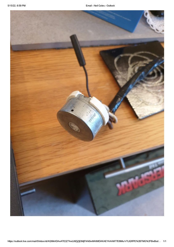

Hi, just removed the ignition switch from the back of the steering lock, as it has basically fallen apart. Just looking online at replacing it and came across this:
https://www.autoelectricalspares.co.uk/ ... 1052-p.asp
Apart from having an F suffix and a different 4 digit number, it looks identical. It was fitted to Jaguars and Daimlers from '74.
Can anyone tell me please if this is the same item? It is half the price of the one Barratts are selling!

Hi Neil....im no ignition switch expert. .....the white pink wire is odd on your photo....im thinking your switch is possibly an xj6 switch......could have been replaced previously .....E type typically have a 4 way connector. ...cant see your connector but the link you show is a 6 way.......you can use other switches but they need rewiring and key positions may be different.....Steve

Hi Steve. Thanks for that. Yes, not sure that my switch is original. I have an ex California car fitted with steering lock. The switch fits into the back of the key unit. Although there are six positions on the plug, only three were in use, the others blanked. None of the wires from the loom actually matched the input to the switch! So the one on the Lucas website might just be the same. I'm not terribly worried about authenticity, as long as it looks ok and is reliable!

You could look on ebay and buy used xj6 switch......plenty available. ..and rewire....Steve

Yes your switch has obviously been re wired.....Steve

Yes it seems obvious now! I think I will go for the new Lucas one and wire it up identically. Should do the trick.
