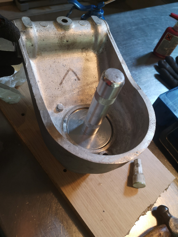

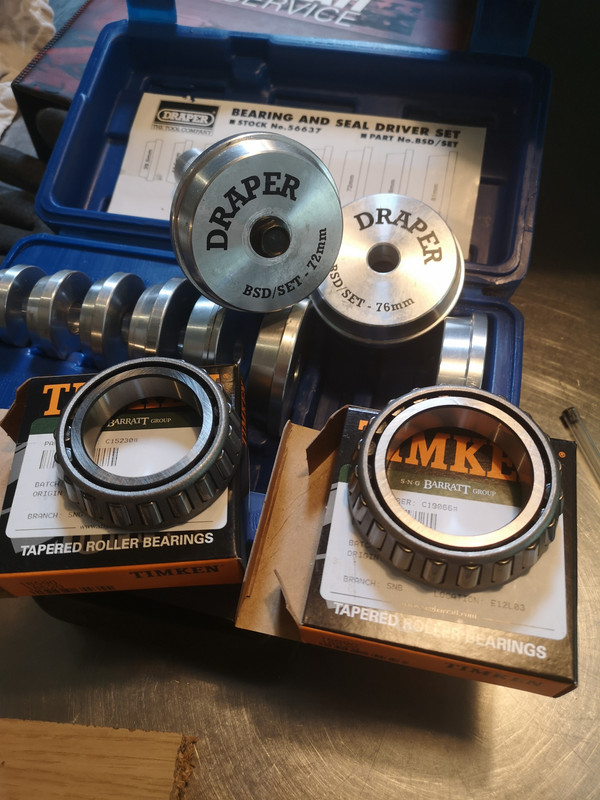

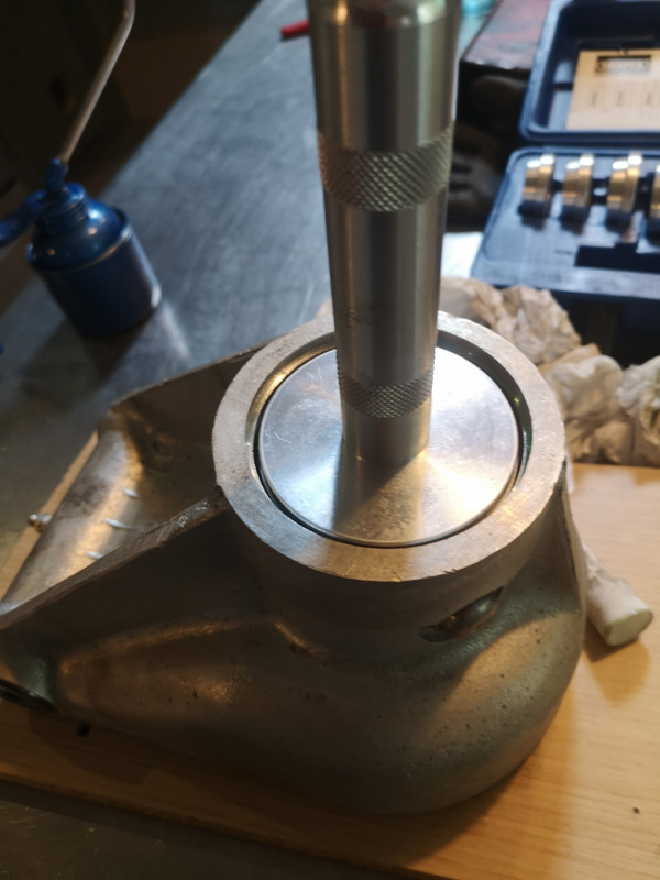

Some thoughts on re-fiting the bearing tracks.
There's no need to use a press to do this, and many advantages in not doing so - far less risk of the races going in off-cock, and taking a shaving off the bore.

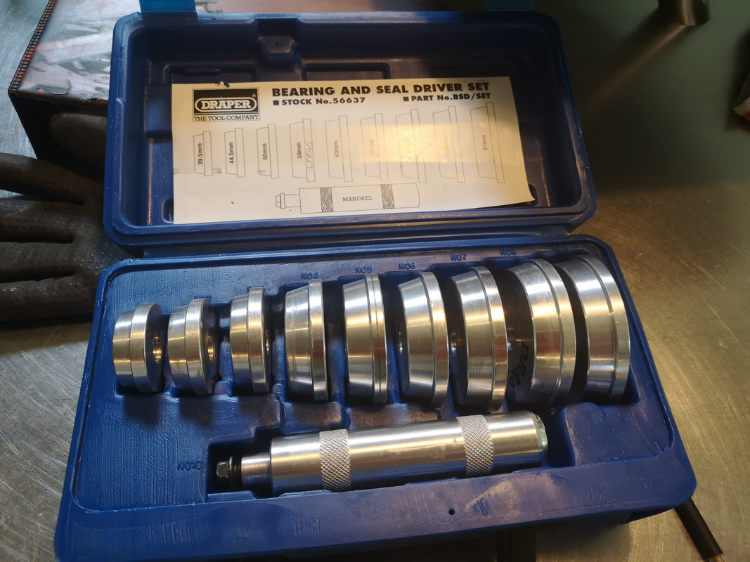

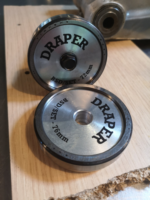

This DRAPER tool set could have been made for working on Jags, the two rings shown were perfectly sized for the rear wheel-bearings, and I've lost count of the number of times I've used them for other jobs.

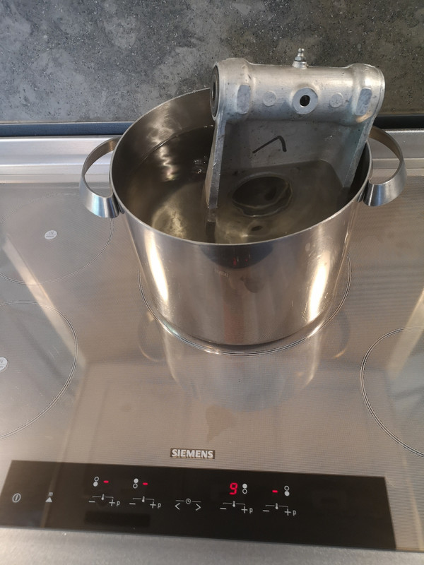

I boiled the rear hub-carrier up as seen, froze the bearing tracks in the freezer, and the temperature differential means that the tracks just literally drop in. A tap on the centre drift confirms the dead-seating ring, music to our ears. The risk to be aware of is that when you do the second side, the first side may still be loose and can move.
I use a drop of Loctite bearing-fit in contexts like these,just to be sure, but this method requires no peripheral hammering or juggling with spacers and anvils on a press that essentially gives you zero feedback.
Thought this might help/encourage others.
