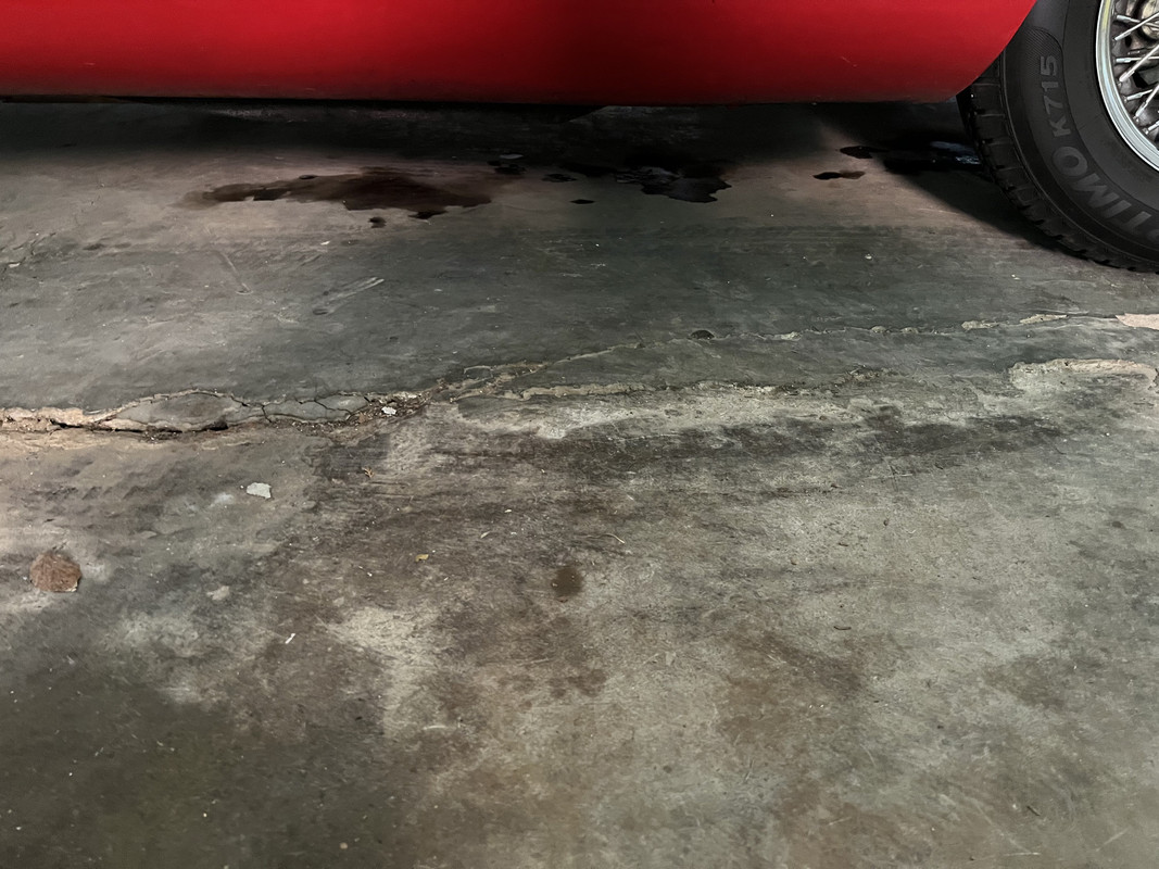

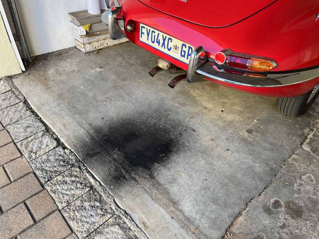

#11 oil spray pattern and spotting
The pics are of the spray pattern accumulating on the garage floor (over several months), and spotting under the car (also accumulated over months). The missus is thrilled. No smoke while driving.
Drove her 120 miles today and left the oil alone, despite showing 1/3rd into gnarled bit cold on dipstick.

That black deposit is very likely just to be carbon washed from the exhaust system when the engine is cold . Having just looked up Sandton and seen that it is 1600 metres = 5250 feet above sea level, I do wonder whether you are over rich , and that is leading to excess oil consumption . I think at your altitude, a weaker needle than UM would be justified

If that's months accumulation of oil I would not be concerned at all, IMO you are doing good! And it actually looks like more than it is. Put a little absorbent tray down.
I think you will spit carbon. Since that is over several months it really may not be too excessive, but you are using quite a bit of oil and that will contribute so not a surprise. Clean it and see what it looks like after a start up or two.
You have downturn pipes so it goes to the floor. My 62 has the pipes straight out, don't want park close behind on startup.

I get the same carbon deposits, even though engine is excellent. I have cardboard sheets behind my (straight) pipes to stop the black going onto the shelving behind it.

Thanks guys; I am comforted.christopher storey wrote: ↑Sun Jun 19, 2022 10:19 amThat black deposit is very likely just to be carbon washed from the exhaust system when the engine is cold . Having just looked up Sandton and seen that it is 1600 metres = 5250 feet above sea level, I do wonder whether you are over rich , and that is leading to excess oil consumption . I think at your altitude, a weaker needle than UM would be justified
After the first about a year and a half of gradually getting teething problems smoothed out, I had adopted a very strong 'ain't broke don't fix' policy on the basis of a devil I know, and if she's been running for many months on end with no serious issues, I regard this as such a blessing that I have them mess with settings and the like only when something goes wrong. I'll bear in mind the potential for a slightly leaner setting for next time. The clock is coincidentally with someone who does one of these modern fixes on the back of the clock - I had a proper watchmaker attend to the cute technology of the original clock a few times, but she always stopped running after a while, so I am now opting for an acceptable cheat here.
I'll report back - especially when I hit 20,000 miles since delivery (I am at about 19,200).
