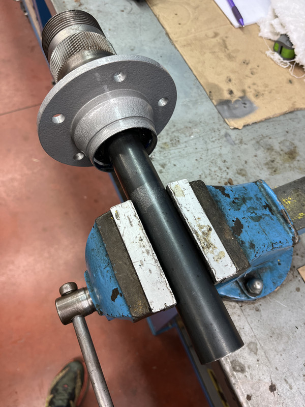

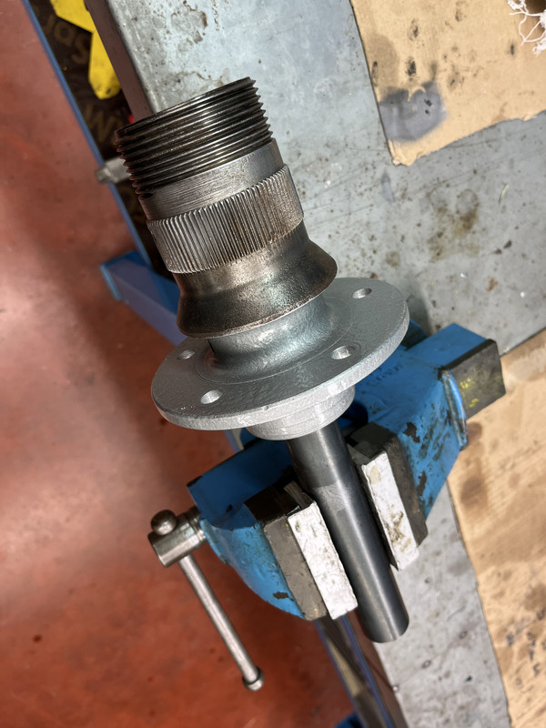

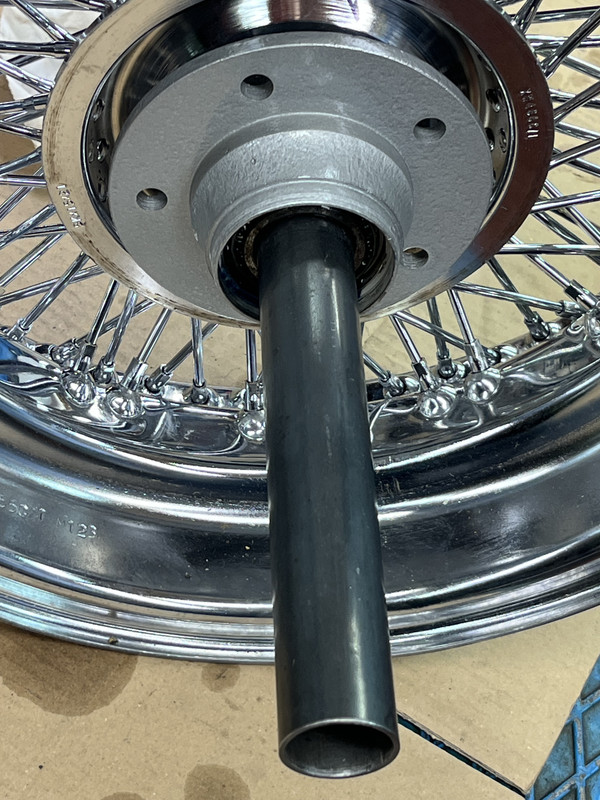

Bought axle/hub/nut/washer/usable bearings from Ken Jenkins, £130 inc VAT and shipping.
35mm steel tubing with a bore that's a perfect match to the axle, and forms the back lip for the inner bearing, a slug welded where the upright-nut would be, and two locating welds through the flank.
Mounting jig now built, and wheels are with the wheel-builder.

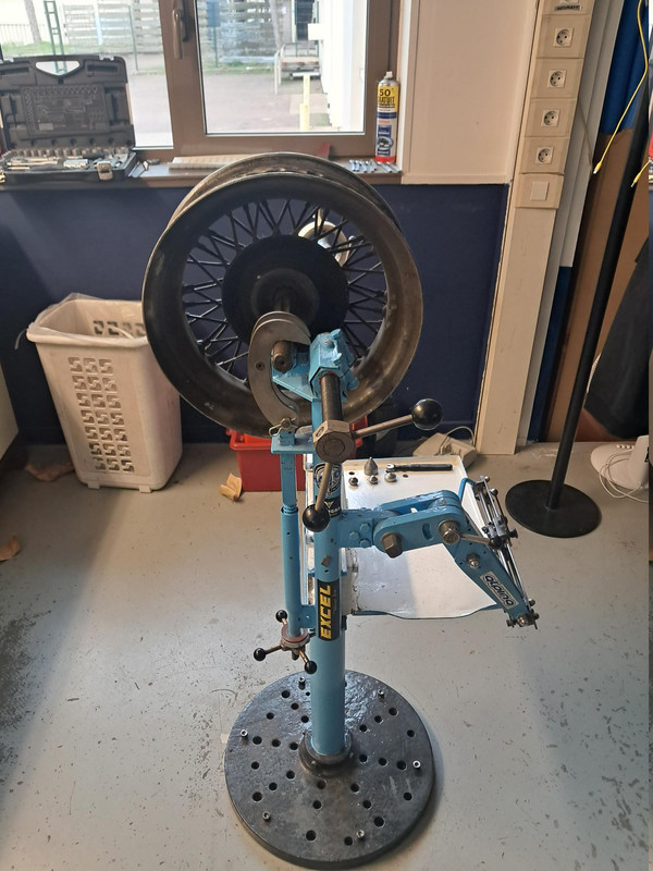

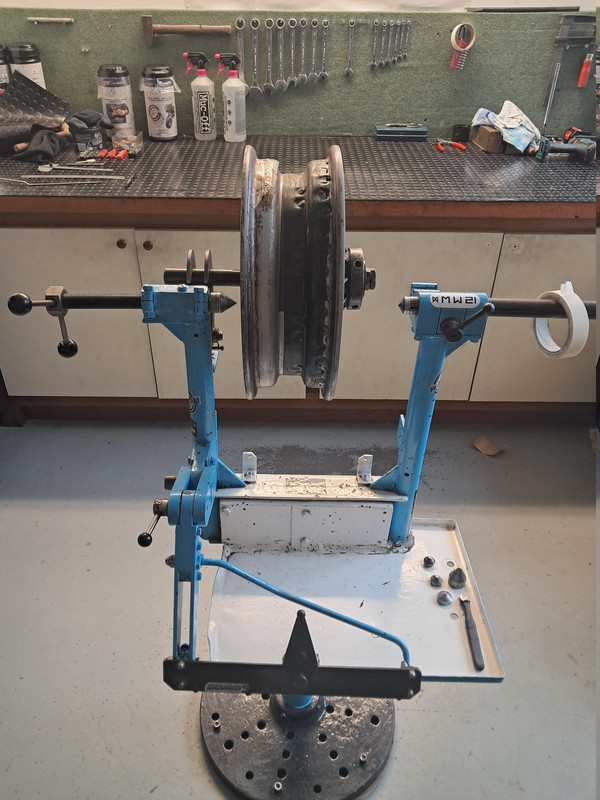

Getting spoke tensions checked and wheels tweaked to run as true as possible, French wheel-builder does other cars but had no mandrel for Jaguars.
The wheels still look brand new after 35 years (MWS - India) but believe there may be room for improvement.
Have also now got Jaguar-specific wheel-balancing-machine cones in aluminium, rather than nylon, as cranking the eared-nut up hard to truly centre the wheel is - in my experience - important, and you can’t do that with the Smoothride nylon ones without splitting the outer.
