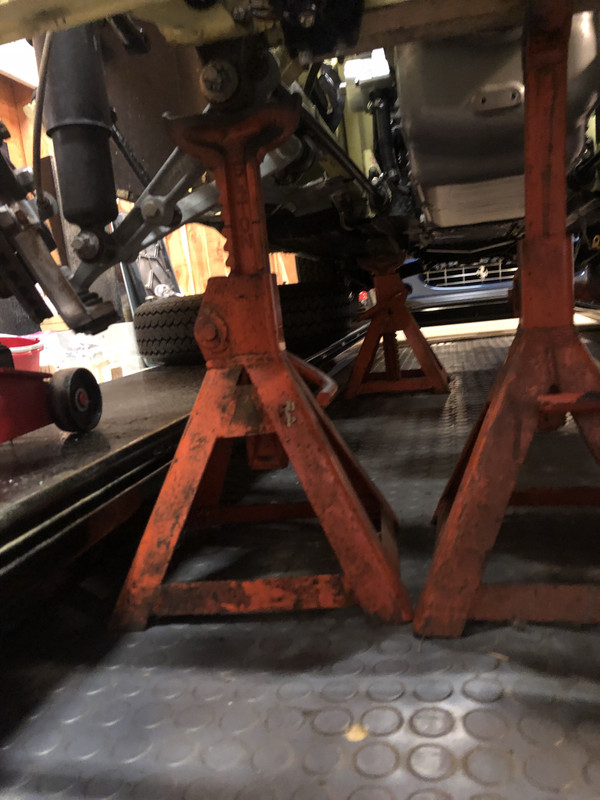

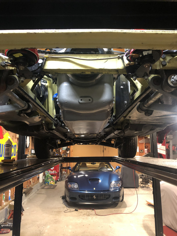

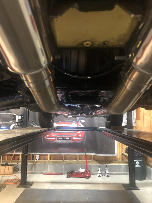

As we return……..
The exhaust
The Suspension and
Torsion reaction plate are all in!

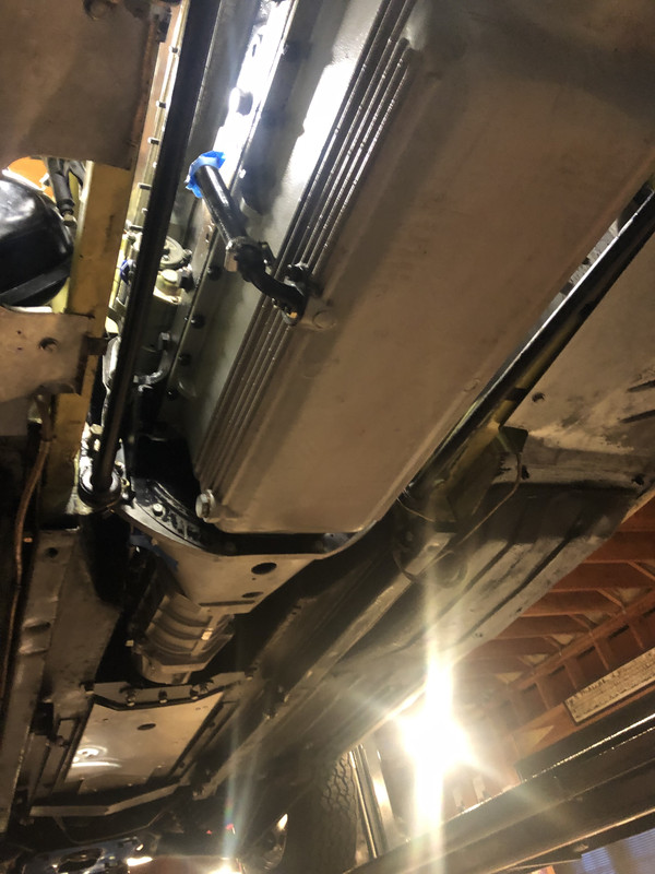

Tonite hopefully Steve will do the following to complete the job.
Spoke to Guy Broad,
1. Either a side tunnel access hole with a rubber plug
Or
2. Access panel on top of tunnel for full access.
Pics to follow.

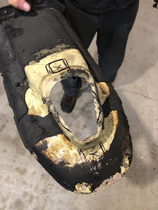

Second
The transmission cover should be cut to relieve shift arm clearance and reverse switch.
Pics will follow.
It must be done to fit the cover!
More to come, by the weekend the car should be running if Steve comes by for the Peop shaft.

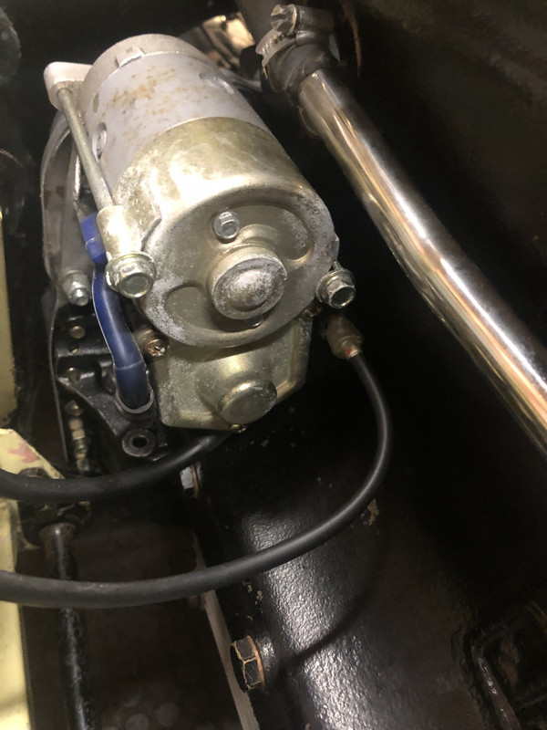

The starter is the SNG mini
Great unit
Kookie positive cable bolt location but works great!

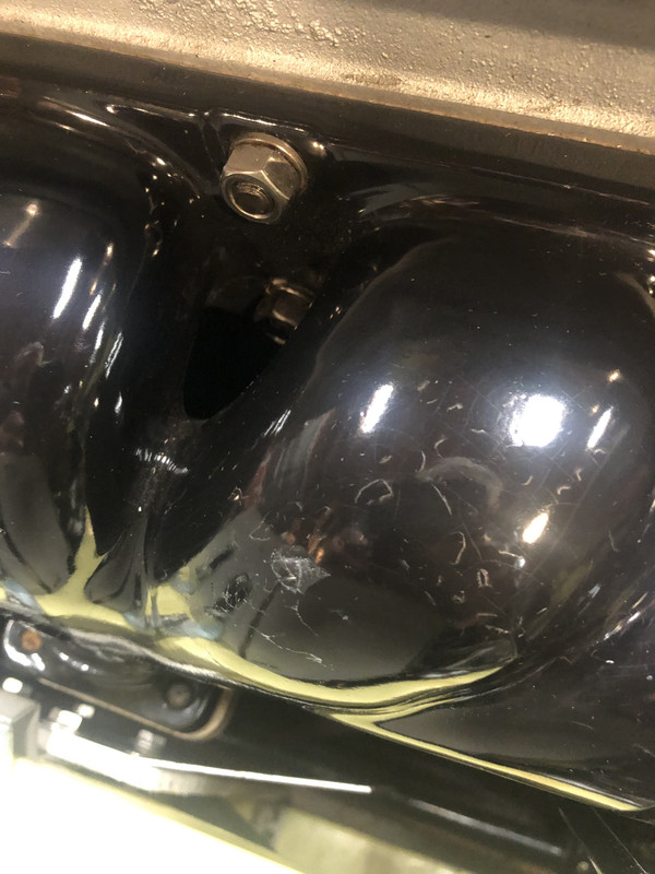

SNG manifolds
They are cracking BUT….
That’s 9,000 miles in 11 months!
Extreme heat and cold
I’m happy and the fit and finish were great

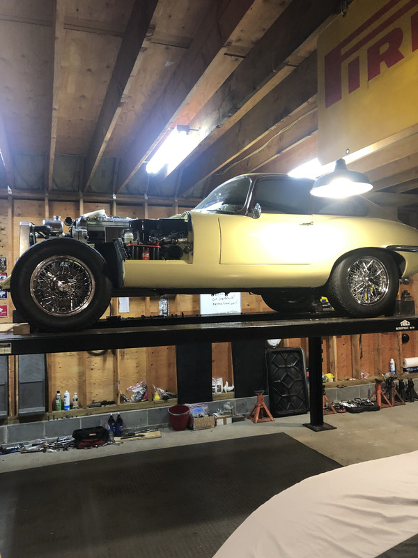

Okay guys , 9/21/22 ,hopefully today we make our MASSAGE cuts and by next week the car is running.
Its taken a good 8 weeks with family issues and all but fairly fast for all the work we have done.
We recap after tonite....
Take your geritol because old men get queezy with whats coming

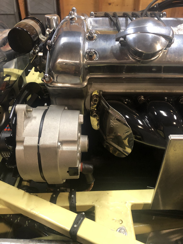

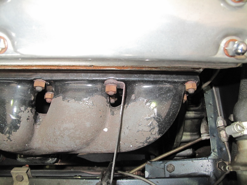

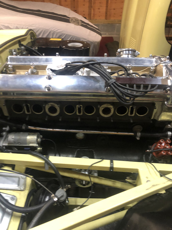

Joey
I think you have the distance piece C11583, fitted to the long stud between the dip stick holder and the manifold, the wrong way around:
The way you have it pulls the dip stick too close to the manifold.
S1 OTS OSB; S1 FHC ODB
#312 Re: The 5 Speed is here……..
I don’t know
Maybe it’s the angle of the photo
What other way could it go
Gtjoey1314
Gtjoey1314
#313 Re: The 5 Speed is here……..
Spacer goes on stud first, then bracket, then nut. Yours appear to be: bracket, spacer, nut.
#314 Re: The 5 Speed is here……..
I understand now....My studs all the same size.....
I havent had an issie.
Thats a lock washer.I could put it behind the bracket?

The long stud is C7624 and there should be one for the dip stick bracket and also retaining the alternator shield. https://www.sngbarratt.com/English/#/US ... eBranch=US
Not essential I suppose but Jaguar thought so
The distance piece is no longer available but a few washers would do the job.

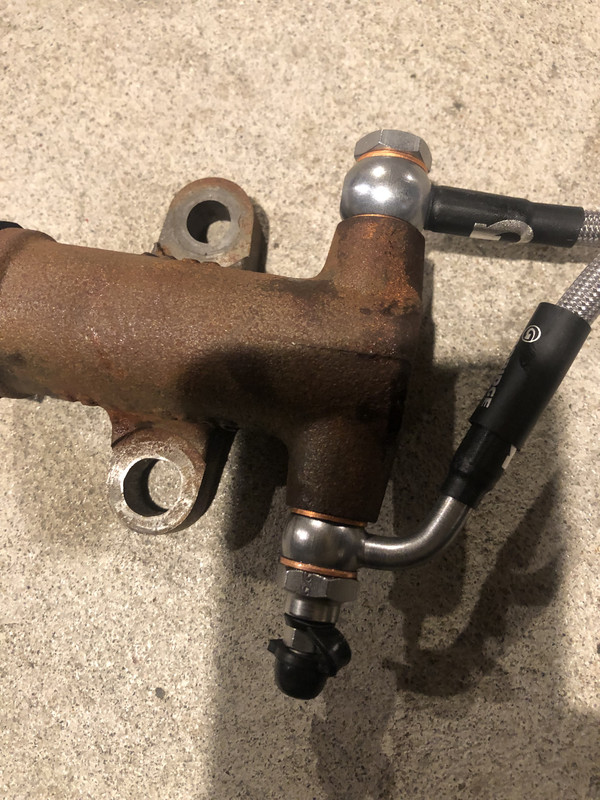

I tell you, It is snug in the clip, so it doesnt rattle.
Good eye.....now look at this my friend.
What say you!
What say you!
#317 Re: The 5 Speed is here……..
Cute! That bottom bleed screw has always been a trial. When reinstalling the slave I use an Allen bolt on the top as it easy to get a Allen key in to tighten, not so with trying to get a wrench on the nut.
#318 Re: The 5 Speed is here……..
The prior owner , went stud on top, bolt on bottom.....same effect
gtjoey1314
this kit should work pretty good
gtjoey1314
