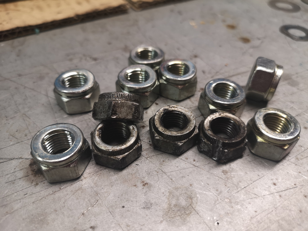

I thought this might be useful for anyone who is changing their discs or rebuilding their IRS. Philidas nuts (7/16in UNF) hold the discs and the ones that I was supplied permanently deformed the male thread onto which it was fitted.
Fortunately, I only fitted one to the point where the locking thread was engaging and this limited any damage.
Prior to fitting The Philidas one I had temporarily used plain nuts which wound onto the threads very easily. After use of the Philidas nut the plain one also became stiff showing the thread had been affected.
I contacted Philidas and visited their trade counter where the guy was able to tell me that it wasn't a Philidas nut at but a pattern part. There are 3 types of Philidas nuts as shown in photo. The second photo shows both the pattern part (LHS with knurling) and the correct Philidas Industrial nut. The correct one wound onto the thread easily and didn't alter it. Hope this may be of help.

Just wondered about your reference to “Philidas” nuts for the metal self locking nuts on the half shafts. I realise why there has to be a metal self locking nut, as opposed to a Nyloc type nut with a nylon locking insert due to the heat generated by the brake discs, but on all the many Jaguar diffs that I have worked on, I don’t recall seeing a Philidas type of nut.
The Jaguar Spare Parts Catalogue calls up part number C15349 (Nut, Self-Locking), but these are usually of the “Stover” type. These are longer in length and more substantial than the knurled type and are still available from suppliers, but many of the “usuals” offer the shorter 7/16in UNF knurled nut as shown in your second photo, which I personally feel doesn’t fit the bill in terms of looks or originality. S N G Barratts also offer this knurled nut as an “aftermarket reproduction part” alternative, but they do offer a longer and more substantial nut on their website as the original “Genuine” Jaguar nut and call it a “Nut-Stover 7/16” UNF”, although this is still not of the “Stover” design which has a rounded top in the locking area. I think the “Stover” type maybe because the nut locking area is slightly elliptical and it is as this top area is tightened around the bolt it grips it tight without damaging the bolt thread. Just a thought.

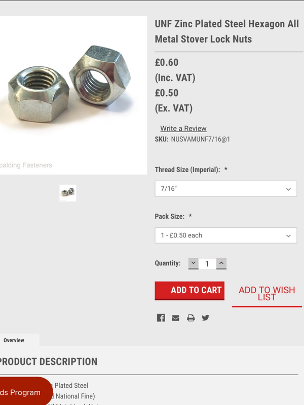

Hopefully the photo below shows the Stover design which is available from specialist fixing suppliers such as Spalding Fasteners. I have no allegiance with Spalding, but just wanted to give my alternative metal self locking nut which I feel more suits the original design.
