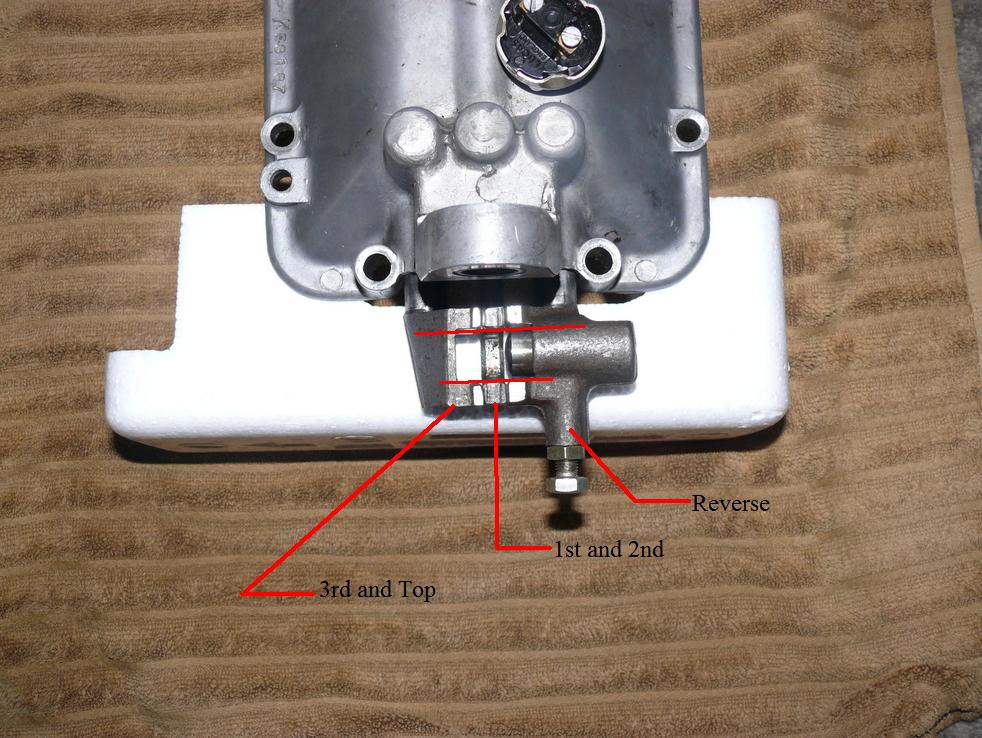

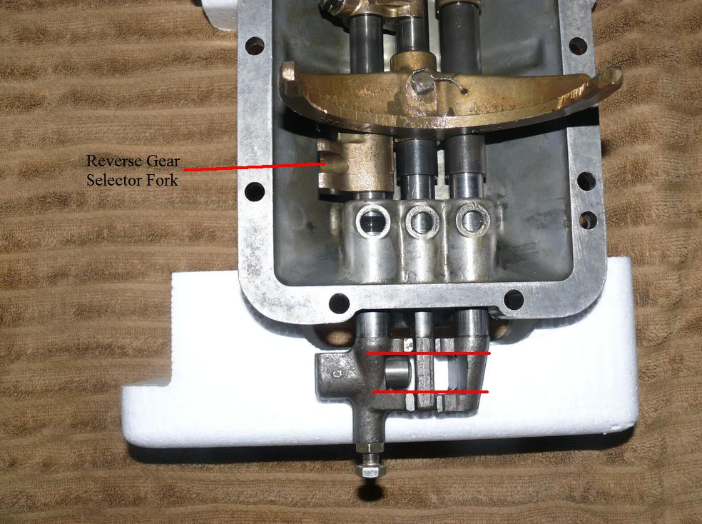

The first motion shaft is the input shaft in the bellhousing . There are 3 selector rods which each have a slot at the rear end.That for 3rd/top gear is on the left, that for 1st/2nd is in the middle, and that for reverse is on the right ( all looking forwards ) . Lever the shafts gently so that all the slots are in line, and neither frowards nor backwards of the central position , and that should be your neutral position when both input and output shafts should be able to rotate independently of each other. If that is achieved, put the lever on and check that all works normally in the usual gear positions

#7 Re: S1 4.4 gear selection
Post by angelw » Wed Jul 20, 2022 1:06 pm
Bryan Wrote:
What should they look like in neutral. Which is the first motion shaft ?. We have tried putting the gear lever in and it seems like it is in neutral but will not select any gear .
The following pictures are the visual of Christopher's written description for the Neutral position of the Gear Selectors.
Bottom View
Top Cover

Glad you got a good result, and particular thanks to Bill for the detailed and annotated photographs .

Yes they were very good photos really helpful. Many thanks Bill .
