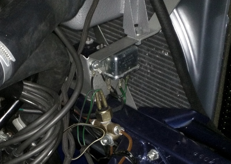

Hi Richard, as stated the fan circuit works ok providing 12V is present on the variable thermostat, which feeds the relay, still can't find the brake light switch, remember this is a 1962 series1 3.8L that has been restored. If anyone knows where the brake light switch is on this model please let me know. Thanks for the reply.
#6 Re: Gremlin attack - help
Danny....front frame.....look through the S1 3.8 factory fit section..lots of original detail and photos...Steve

Go slow, since your early car should have the BRAKE LIGHT SWITCH up front near the RADIATOR AND your HORN connection is right there as well as your FAN CONNECTION.
Look for water from hose making the connections wet or GROUND wires wet or cut......
Take a test light and touch each connector with the key on .
Once you isolate each section it will come together fast.
