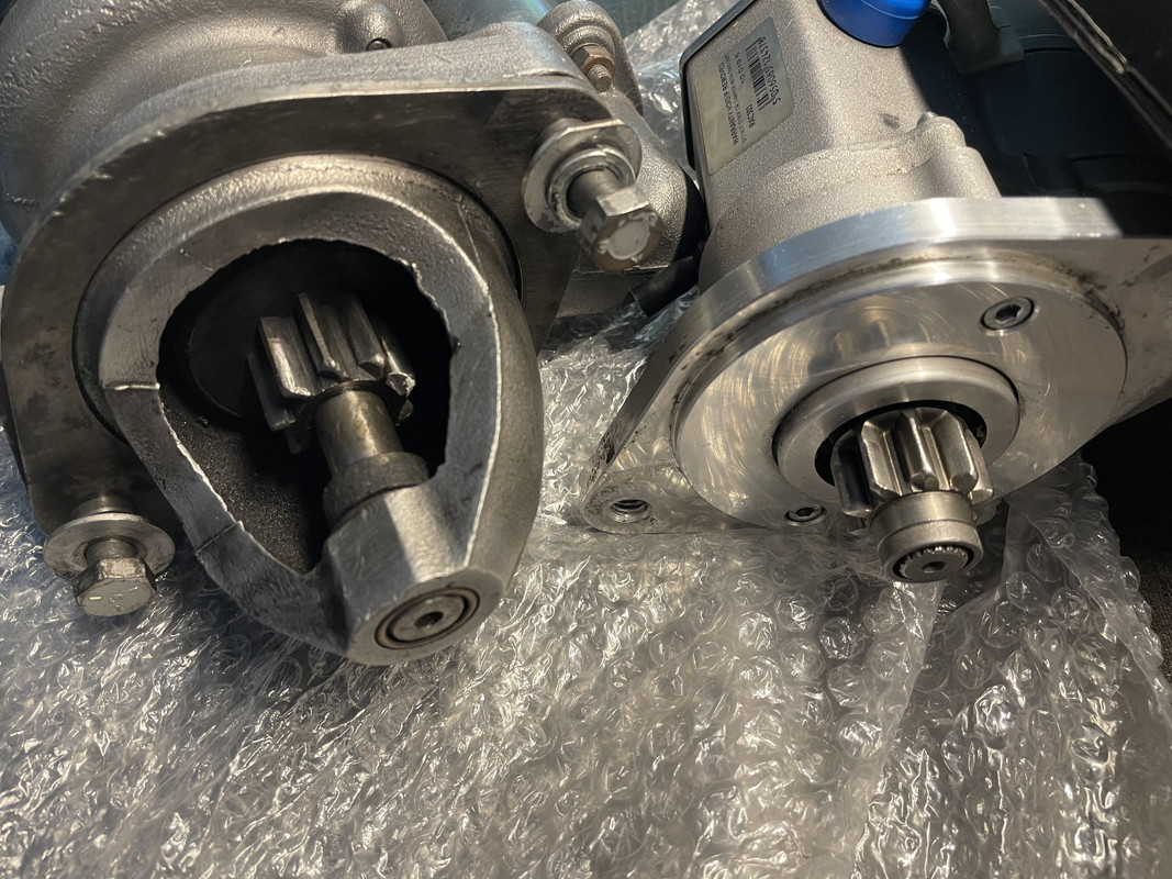

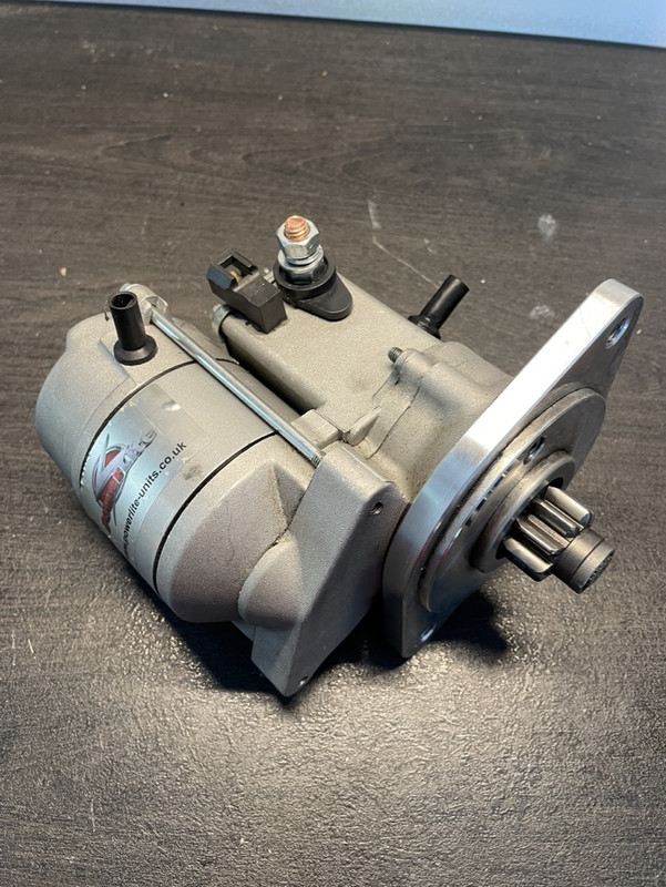

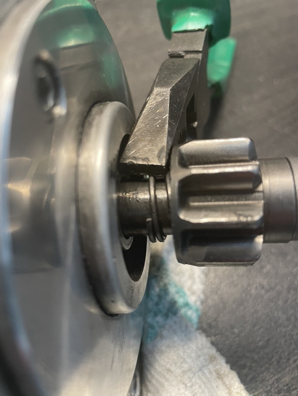

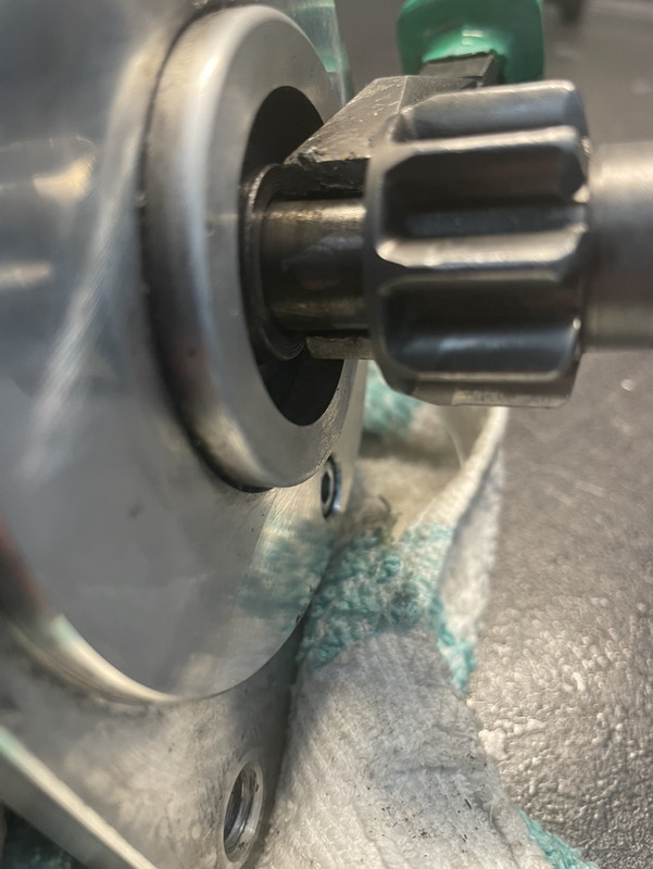

I replace my old starter motor to a Powerlite gear reduction starter motor a 2 years ago. I did notice that it had problem getting the starter motor to really engage to to the flywheel ring gear but thought it had to "wear in" a little. Today it just spins when I turn the key so I removed it, tested it in a bench. Seems like there is a spring or a part of a spring missing. When I test the motor, the "Bendix" gear isn't thrown out, instead floating on the extended shaft. I think the spring has been broken since there are a piece floating on the shaft. This could explain the problems I have had almost the whole time.
I would guess I used it maybe less than 100 times (Corona stopped all driving for nearly 2 years) and this is the first year I really used it since the rebuild.
Am I right in my assumption that there is a broken spring and is this a known problem with these starters?
I don't want to put in a new one and have to change it again next year, considering putting the old one back :?: . Then there is the question if I need to replace the ring gear or it will still work with a new starter :scratchheadyellow:
FYI, I have the correct starter without any shim and It does engage almost the whole length of the teeth on the Bendix gear.

I can't answer the questions about the starter but that ring gear is a mess.
Pragmatically though, you have nothing to lose by installing another starter and seeing what happens. If you get lucky and it continues to work you avoid taking the engine out.

I agree with Andrew and Steve : something has gone radically wrong and has chewed up the ring gear. What is not clear to me is which came first i.e was it the damaged ring gear which broke the starter, or was it the broken starter which damaged the ring gear ? I think the latter is the more likely . Personally I don't think that ring gear is salvageable

That flywheel damage is bad, suggests to me the pinion and ring gear are incompatible, is the diameter of yr OEM and geared starter pinions the same, also the number of teeth?
Either the pinion was incompatible causing the spring to break or the broken spring was the culprit, allowing the pinion to grind against the ring gear as u drove along? I doubt the latter because the noise would have been tremendous ...

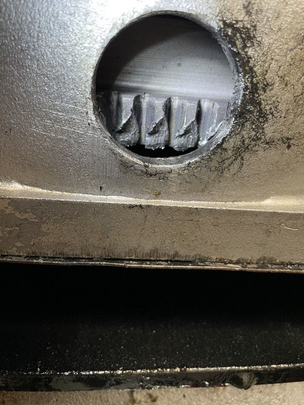

The flywheels ring gear is another story, I turned the crank by hand a full revolution and its only partly damaged in few places so hopefully it will be good enough for starting. I will try just to bolt on the Starter when it's fixed and hope for the best, Remove the engine is something I want to avoid if it isn't necassery, at least not now during our short summer season.
My theory is that the spring has been defect/broken from the beguinning and has never fully engaged to the ring gear, probably bounced and sometimes ended up in a position to crank the engine. The engine has always been starting without any hasitation so the small grip has probably been enough but also damaged the tooths in the ring gear.

Hi Peter. ....i would at least try to tidy up the damaged teath with a file through the starter access hole....Steve

Peter: if you take out the air filter canister complete, you should be able to reach the ring gear reasonably comfortably from the side

Took 3 days to tidy up the damaged tooth’s on the ring.
Got a new starter motor today from SNG after I talked to Powerlite and SNG Barrat, they where both very helpful.
Mounted the new one and tested it without spark plugs, spins very nice and no strange grinding or other strange noises.
Still, when cranking the engine and the engine starts there is some noice like if the bendix gear isn’t retraced fast enough, don’t sound right. The good thing is that I can use the car now but I probably need to change the ring gear and i will probably remount the original Lukas starter motor.
