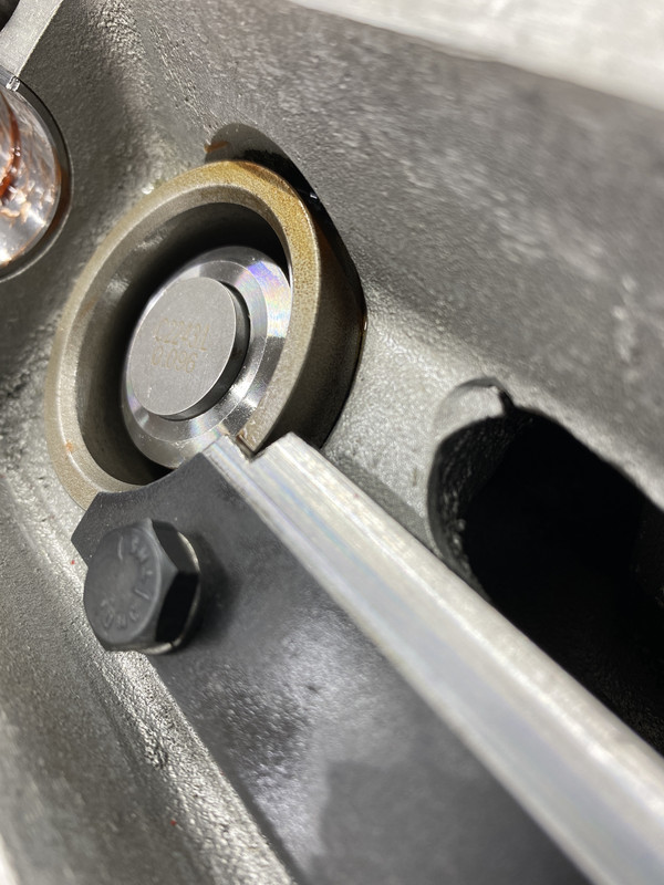

Photo of a shim in place - held it with a spot of assembly lube.
Diameter of shims is 11/16".

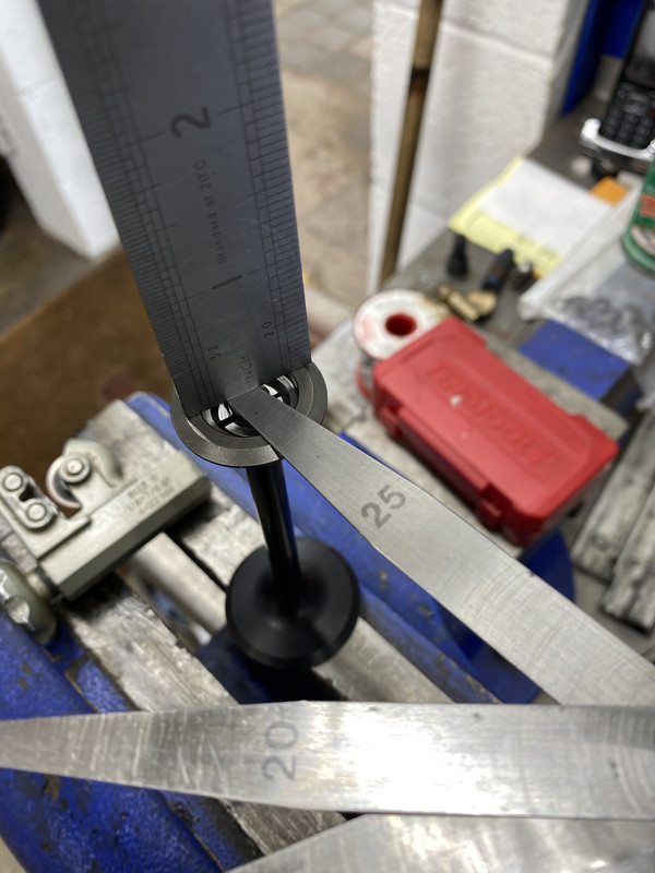

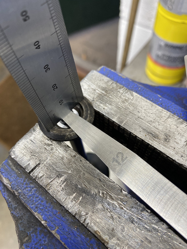

To help illustrate the bit I don't understand, here are two photos. Both are of the same valve, with the same collets. The tight one is using the new, short collar, the loose one is with the original, long collar.
I know these are not ideal in that there is no spring compression here, but both were gently tapped into place with a brass drift.
I reckon that either there was more to the design change in the collars than merely reducing their height, or the modern replacements are not made to the same dimensions. If all my shims would sit at 12thou below the collar height there would be no problem at all. These are the SNGB collars.
I don't get it - surely half the restored Jags out there would have this problem, as these seem to be the only collars now available? Jag classic have discontinued theirs.
It seems to me that the aftermarket collars have the taper that the collets sit in placed less deep than the originals. This is very difficult to measure, but the collets definitely sit more deeply in the old collar than the new. Car has done 77,000miles, not that much for a 67-yr-old.
I don't really want to have to find a machine shop to reduce selected valves by varying amounts, so I may end up having to ditch the stem seals and reverting to the original caps, which would be a shame.

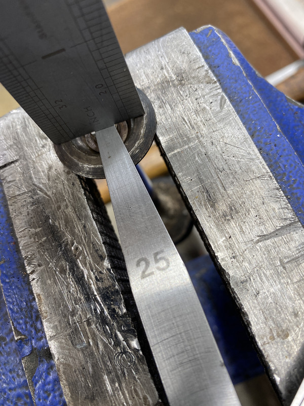

...and here is an original valve with its original keepers and collar:
Now that's much more like it - as so many of you have said, there is a parts mismatch here (a thought - why on earth didn't I do that before??) I am very relieved that it doesn't look like a fundamental (=expensive) problem.

Yes, it must be - if I assemble old collets and old collar on the new valve I get 25thou, same as the original valve.
I've just tried a third sample new collar and it is also wrong. Of course these may all be coming from the same supplier ultimately, but for obvious reasons no-one will tell me who makes their parts so I can't be sure.
For peace of mind, I think I'm going to have to use original collars with original collets on the new valves. I'll have to experiment to see if the stem seals will be a problem. The old collars are deeper than the new ones, which must be for a reason.
Does anyone know the reason why the collets and collars were redesigned, presumably pretty early on in the XK engine's life? abowie says in his post that the seals will not be affected, although I have been told this was the reason for the change.

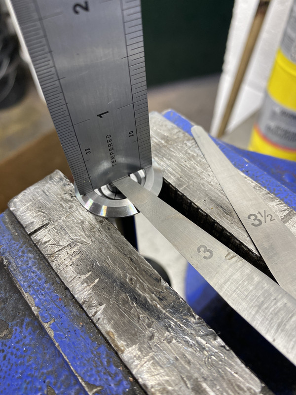

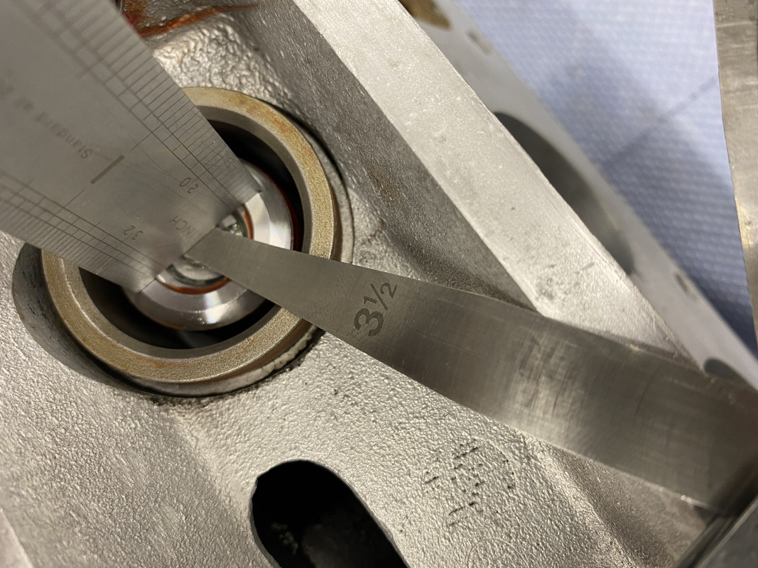

I think I’m making some progress on this. To try to get the bottom of the problem I ordered a single valve collar from Moss Europe, purely on the basis that in their photo their version is a different colour.
It arrived today, and is clearly of a different manufacture from the SNGBarratt offering (which Beere’s also supplied). It is short, the same length as the SNGB one, but does not have the tapered end the others all seem to have (but the longer original did not have).
Here’s a photo of it assembled with the new valve and new collets:
and a reminder of the SNGB version, assembled with exactly the same parts:
a loose 25thou clearance against a tight 3.5thou.
Clearly these two have been machined differently. I should give both Barratt’s and Beere’s a call to make them aware of this, I think - I don’t think I’m imagining it…
