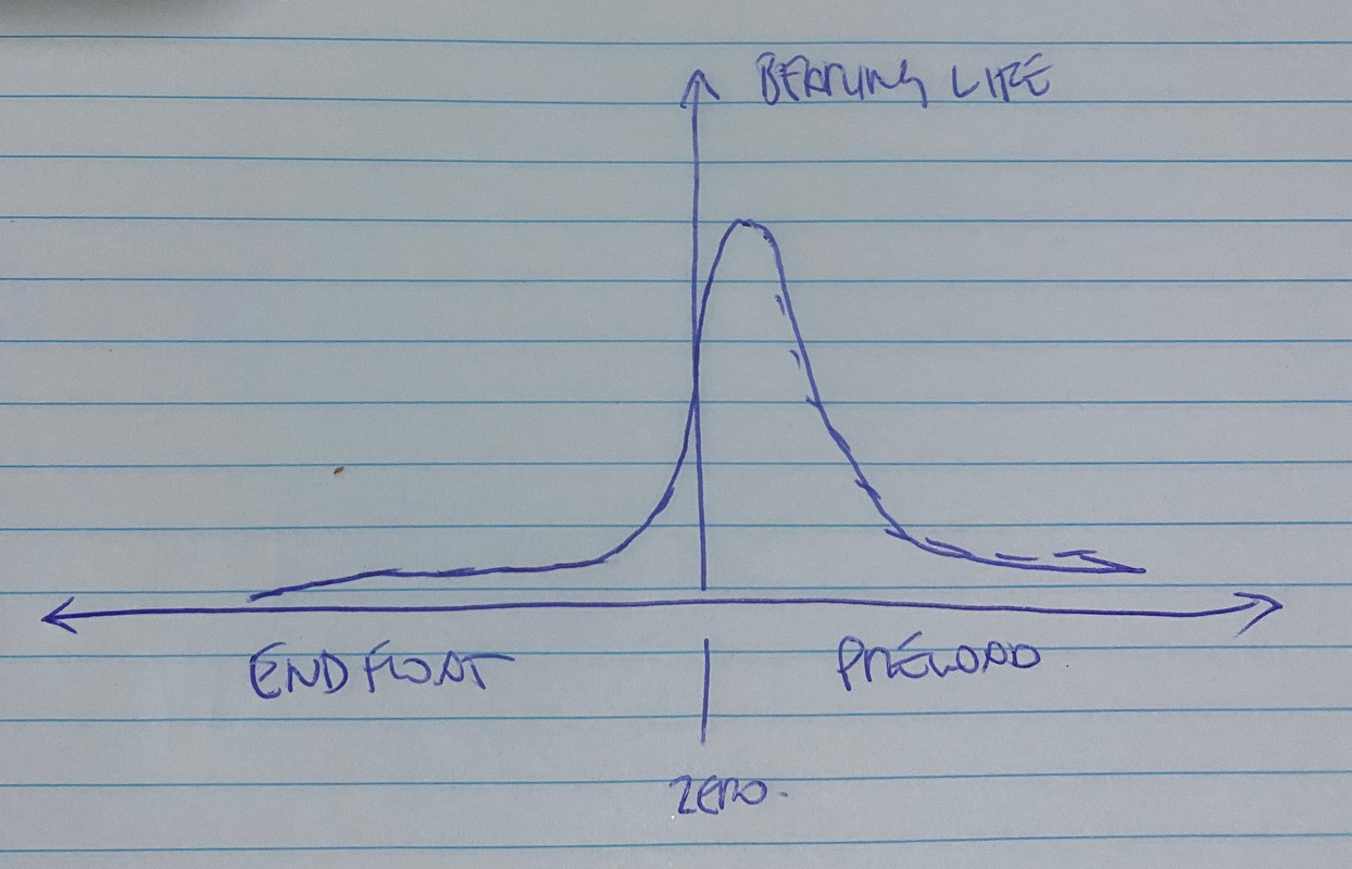

With regard to endfloat vs preload on tapered bearings. I did a bit of reading on this a while back.
If you look at lifespan of bearings vs endfloat/preload you get a graph that looks a bit like this (apologies for my laughable inability to do this with a computer program). Note that while this is very rough, the slight shift across to the preload side is accurate.
Manufacturers of tapered bearings usually specify a small amount of endfloat (looseness) cold. When the bearing comes up to operating temperature it expands and the bearing ends up with close to zero endfloat. At this point there is the best compromise between part location (movement) and bearing wear (tightness).
Depending on the application one of these factors may be more or less important than the other, hence specification differs with different applications.
What you can see though is that if the bearing is very loose or very tight the lifespan of the bearing is significantly compromised.
So for the OP I'd be ensuring that the next set of bearings are set up in spec. The graph above does agree with Bill's comments about aiming for the low end of the endfloat scale when setting up these bearings.

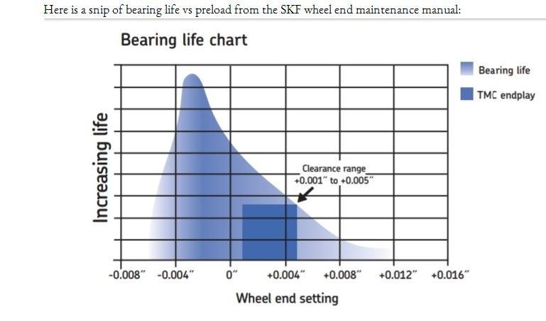

Following is a graph grabbed from an SKF Manual and clearly indicates that bearing life is significantly improved as the bearings are placed in pre-load. Granted there is a sharp drop off in bearing life as pre-load is increased past the optimal point, but even at circa -0.0055" pre-load, it's still better than 0.005" end float. Accordingly, taking into account the longitudinal expansion of the aluminum Hub Carrier, starting at Zero End Float will only improve bearing life as the pre-load on the bearings increase.

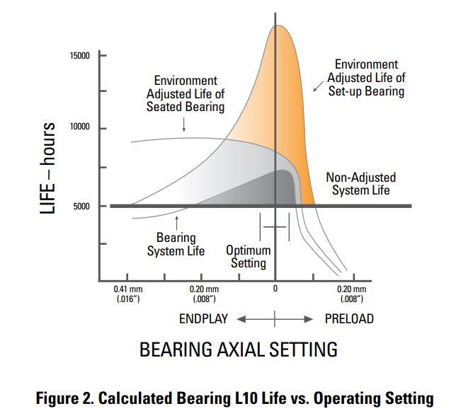

It's so hard for us non engineers to make sense of this stuff. But very interesting.
Looking at them, it strikes me that our graphs are the mirror image of each other...
This is from https://www.timken.com/wp-content/uploa ... hure-1.pdf

Actually, looking at your graph, are you reading it the wrong way?
On the X axis it is is reading clearance. That is endfloat.
So I reckon your graph is identical to mine, just the other way around.
Hello Andrew,
I'm not reading the graph incorrectly.
They're only mirror image in appearance, not in what they are expressing. Typically, clearance is shown as a plus value, therefore, it follows that preload would be indicated with negative values.
In your sketch, you've shown the amount of pre-load as a positive value; accordingly, you would have to show clearance as having a negative amount of interference.
They are both saying the same thing.

Having struggled recently with setting the end play to the 4 thou nominal specified by Jaguar’s manual, must I now rip it apart to go for a preload? Not likely. :bigrin:
Both graphs appear to say the same thing to me.
In the orange graph which has more specific data, a 0.100mm ( 4thou) end play gives a life of around about 1200hr. If you say that most journeys average 35mph then that’s a life of about 40,000 miles….not bad. Certainly not failing within 5000 miles.
My suspicion is that factors other than solely end play/preload contribute more in our cars to failure particularly whether the bearing is axially loaded by the bearing tracks and the squareness of the races in the housings.
Increase in preload due to temperature doesn’t appear to be significant. A quick calculation shows that for a 10 oC rise in temperature, preload would increase by about 3/10 thou.
