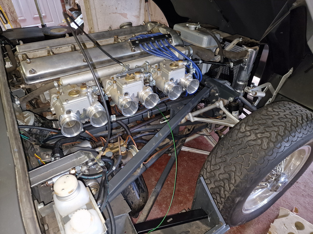

I have just finished this heritage throttle bodied 4.2. It is not tested yet, however it fired up at the weekend and sounds very fruity indeed.
These guys seems to have found a very cost effective way of increasing the output of an XK, by adding a turbocharger. It seems to suit the engine well. Maybe a bit radical for an E type?

That engine spec looks fantastic, are those 45mm ITB’s, I’m just embarking on a similar build, no wide angle head couldn’t stretch but full of other goodies 👍
