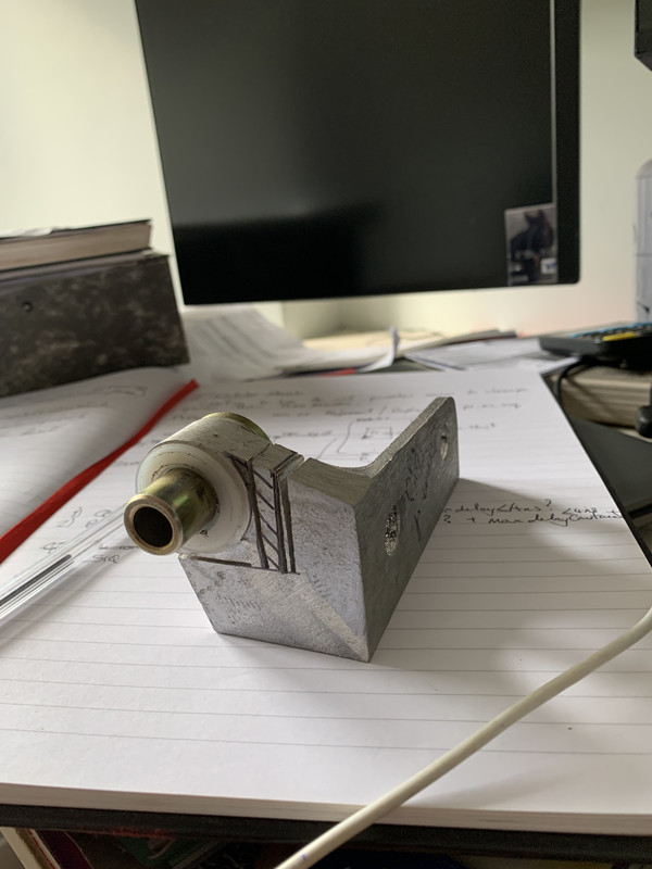

(I have already played the hinge modification game to get more adjustment, I just chopped it with a hacksaw, and got it TIG welded up, picture attached)

... Worth saying I made a small jig to keep everything good and square when welding, and it gave an extra 7mm adjustment for length only. (extra height adjustment was not required.

Your modified pivots won't have an impact on the movement you are seeing. Something is flexing, broken, or loose.
Do you have the nylon pivot bushings in place with new 'top hat' pivot bearings?

Post by keith.brown » Wed Oct 26, 2022 6:38 pm
Steve, I think I do, do you mean as seen in the last picture I put up?
When fitted, they are quite tight, ie no play.
Keith

Post by Paul bow » Wed Oct 26, 2022 6:44 pm
Keith that’s exactly correct, by altering the pivot you will be able to close that gap, the only problem you may have is the inside frame of the lower valance may touch slightly on the bonnet support frame right at the front. Hard to describe it on here but it’ll be straightforward if it does and how to fix it..👍
