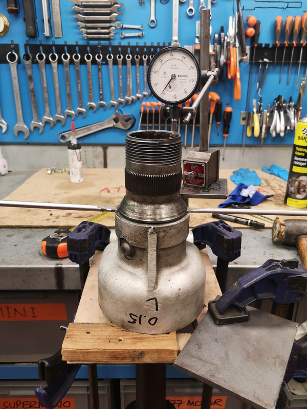

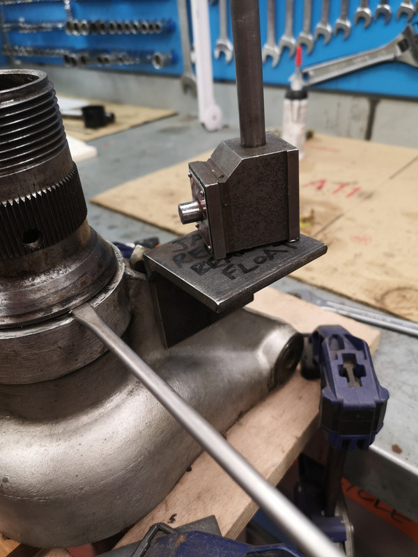

With a Dial Test Indicator and a pair of screwdrivers you can get a reliable and repeatable measure of end float on the Jag rear hub, so why would you just piss in the wind ?

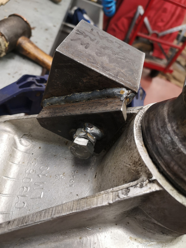

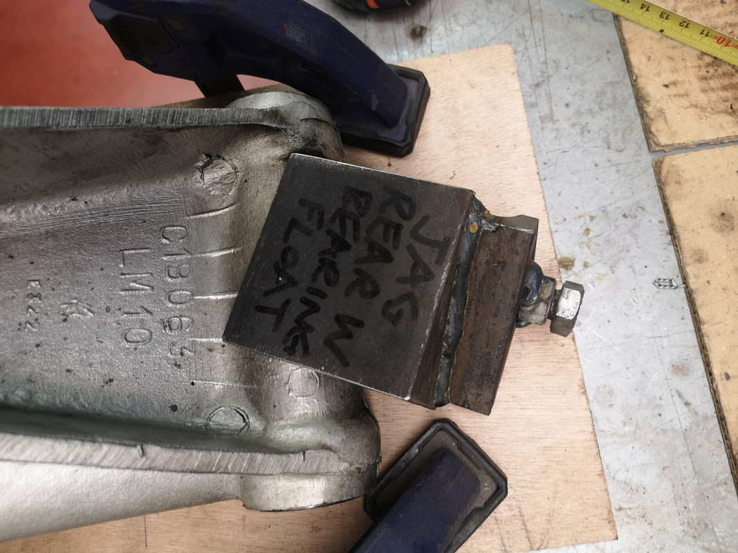

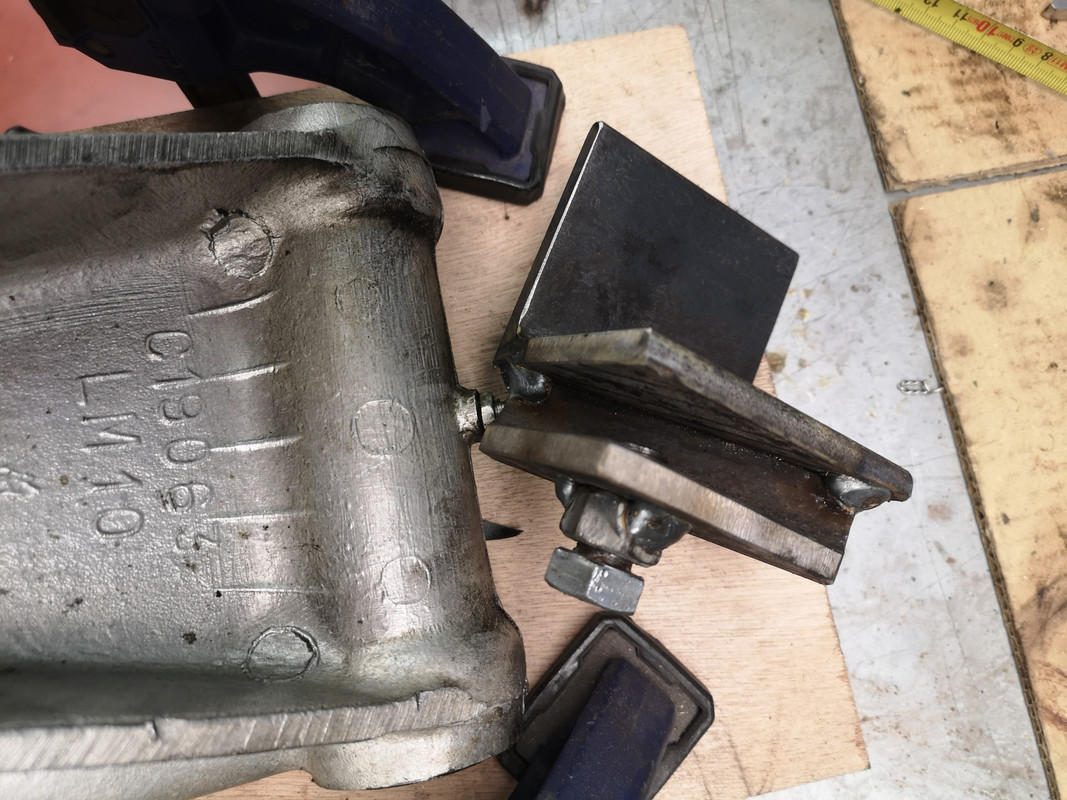

I found that having a solid pedestal made a big difference to my repeatability when using the DTI.
I knocked this up and it made a big difference ; the pictures are on another post already, but relevant on this thread so here they are again, in case they inspire anyone else.
I used a copper hammer each time to push the bearings one-way, which makes the DTI move, of course, so it needs re-aligning with the narrow edge/lip of the splined hub, and then a pair of screwdrivers to maximise the play.
I am confident that this method, albeit depending to some extent on how much effort you put into the screwdrivers, gives me a measurement that is accurate to within 1 thou.

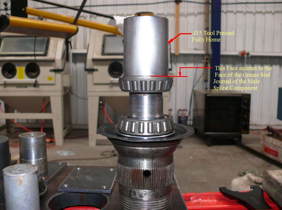

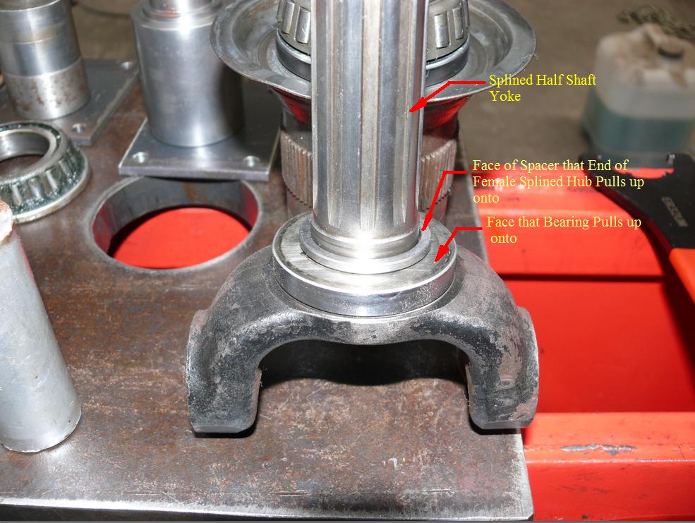

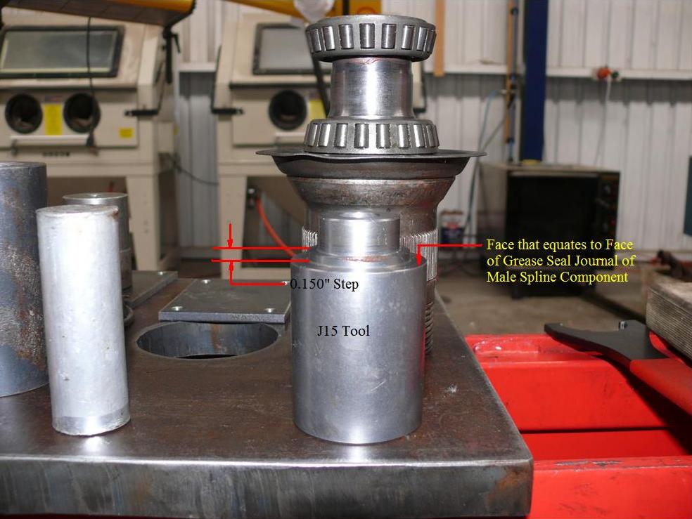

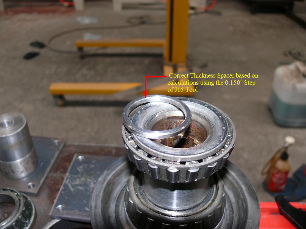

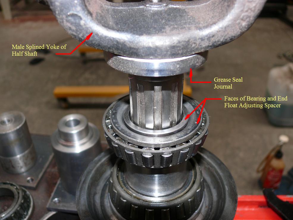

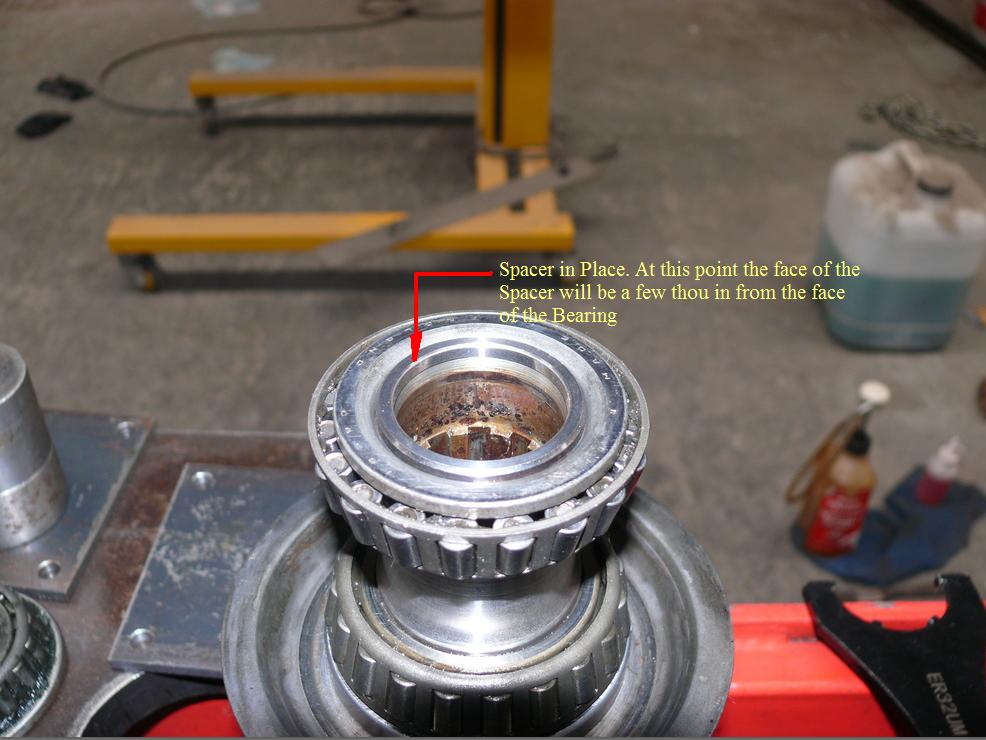

The following pictures are a pictorial explanation of the Rear Hub bearing adjustment. When the JD15 tool is an inexpensive tool to make, or have made, or a Spacer of suitable thickness can be used in lieu of and if your planning on doing maintenance on your car, you will already have a dial indicator, why one would rely on the subjectivity of feel is gobsmacking to me.
What looks like a wood burning heater in the right background, is a commercial Pizza Oven that I use to destroy the characteristics of LocTite when its previously been used in the assembly of the splined shaft with the Hub. Eight ton force is my limit before before employing the use of the oven. Heating with a flame is not all that effective, in my opinion, as there is a lot of insulating air space between the Hub Carrier and where you need to heat. The Oven provides a soaking heat that works very well.
