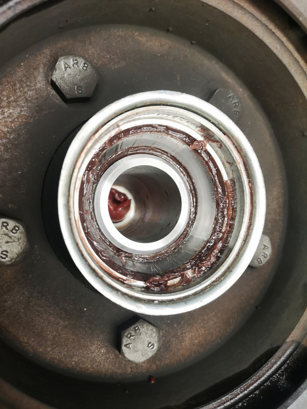

Hi all, I’m rebuilding the front hubs (1973 S3 OTS) and have pressed in new bearings and oil seal. I am re-using the stub axles but both have a slight ring on them in the position of the inner race.
The design of the hubs, with the nut adjusted to leave end float, leaves both bearing races seemingly able to rotate on the stub axle, potentially cutting into it. With the rear hubs it is necessary to press on the bearing races presumably meaning this can’t happen.
Have I misunderstood or do the front hubs have a design fault?

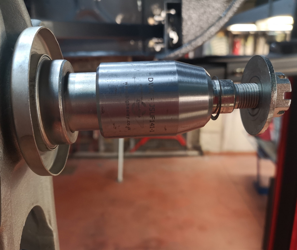

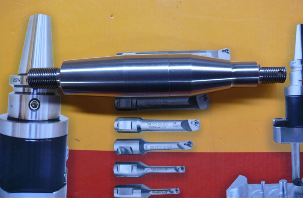

The only difference between the Front Stub Axle for the S3 E and earlier E Types, is the length of the Thread that secures the Stub Axle to the Stub Axle Carrier and the Steering Arm to the Stub Axle/Stub Axle Carrier assembly. Accordingly, the Spacer used between the Inner and Outer Bearings is the same for all models.
The following picture is of an S3 Front Stub Axle that I manufacture. The Inner Bearing Journal is made as an interference fit for the Tapered Roller Bearing Cone.
note the spacer i show is for S1 S2 cars.....S3 have a different size axel and need a different size spacer.
Hello Steve,

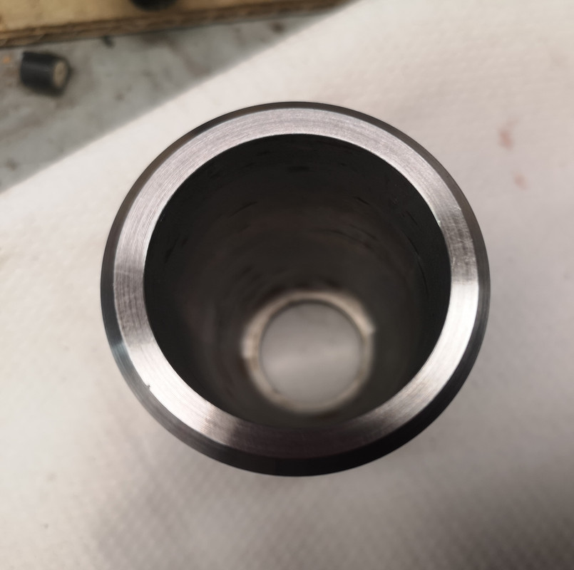

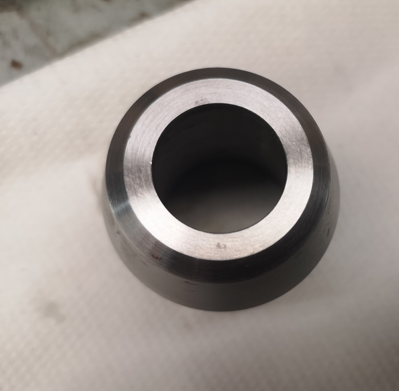

The problem with the spacers is that they cost more than new stub axles.
https://www.sngbarratt.com/English/#/UK ... 0spacer%60
#10 Re: Front wheel bearings question
Hi Andrew.....very much cheaper from Dennis Welch......see the link in a post above....
#11 Re: Front wheel bearings question
That's a lot more reasonable.
#12 Re: Front wheel bearings question
I can confirm that Welch supply a pretty nice product, at a reasonable cost.
The machining looks to be nicely done, and both my axles took exactly 0.60mm (24 thou) to reduce their end-floats to zero.

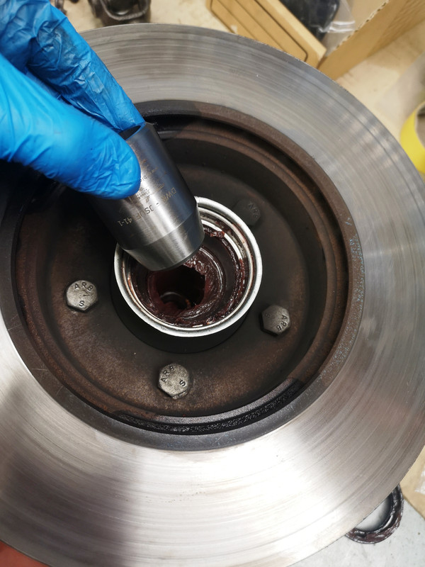

This could be easily and repeatably felt with a pair of jemmies between the hub carrier and the disc, where even 4 thou slop translated into easily-felt motion, so you can shim here with some confidence.
I shimmed with Ducati bevel shims to get those measurements, but now I know what range I'm in I have now ordered the Welch ones as the Ducati ones are a 1mm out on the bore.
Fitting couldn't be easier, as you just pop out the oil-seal and the inner bearing cone, only, then slide the spacer into the tunnel full of grease, replace the bearing and the seal, and shim under the cone of the outer bearing, once you've removed the handful of grease you'll have displaced.

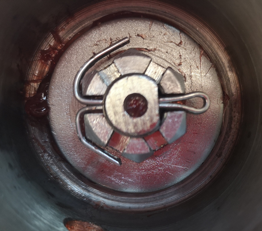

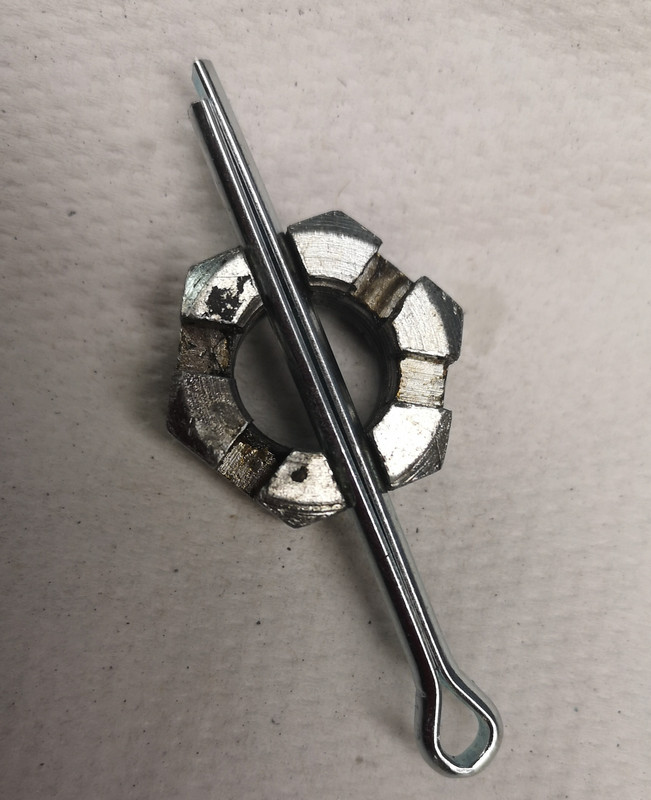

While on the subject, what split-pins do people use here ?
The 1/8" ones I use - seen above - feel a bit feeble, as in practice they're well under 3mm - yet whilst 4mm ones will go through both the castellated nut AND the hole in the end of the axle, the alignment isn't good enough to enable the use of the 4mm through both at once.
#13 Re: Front wheel bearings question
Hi Rory..no other replies so just me at the moment..not specific to hubs but typically I go for the largest split pin I can fit..even if it needs a light tap through...Steve
- Posts: 3665
#14 Re: Front wheel bearings question
As most split pins now available are metric then using the next size up and drilling through as appropriate seems to be the best option and is what I’ve done.
Just to add Light Aero Spares have US spec split pins imperial sizes such as 5/32 which might help:
https://www.lasaero.com/products/article/Q4488XY5
