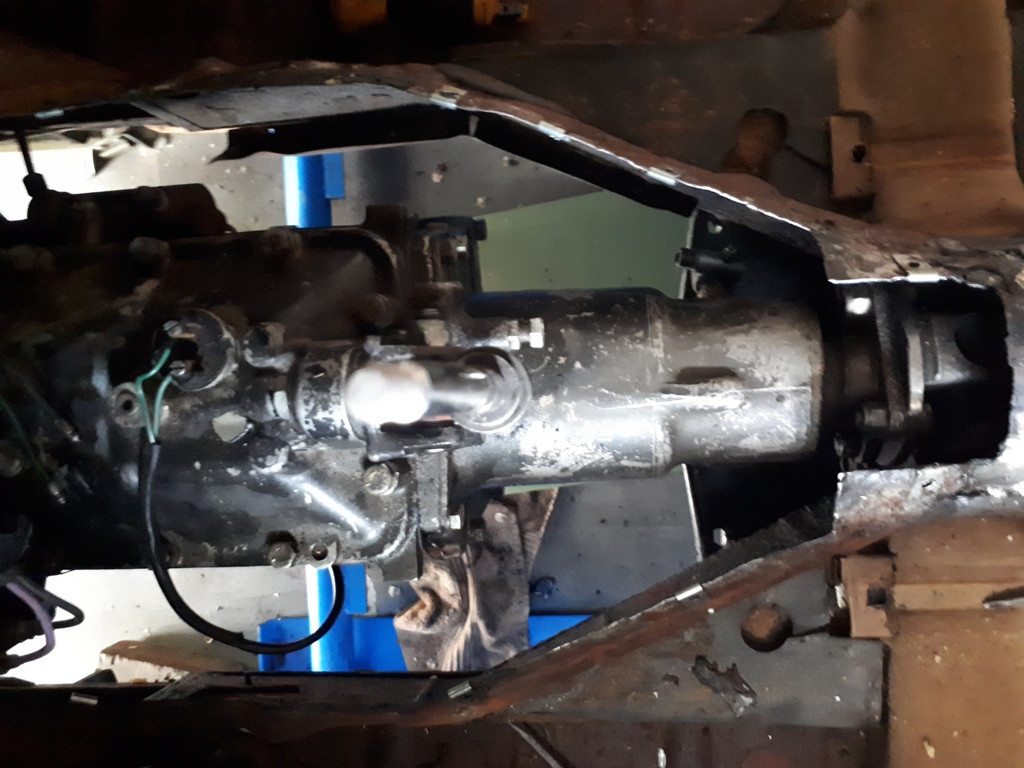

Here is pic of my S3 gearbox with OD fitted, the original extension housing in the foreground, speedo drives superficially appear to be in similar position...

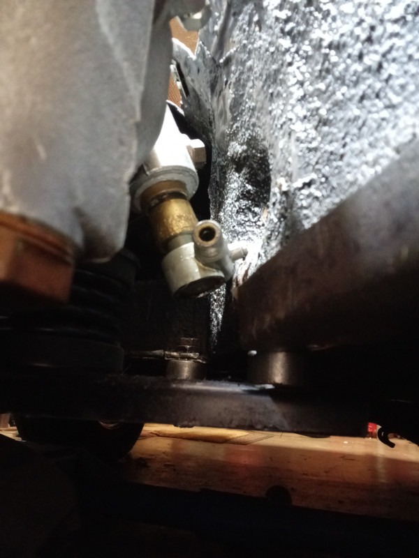

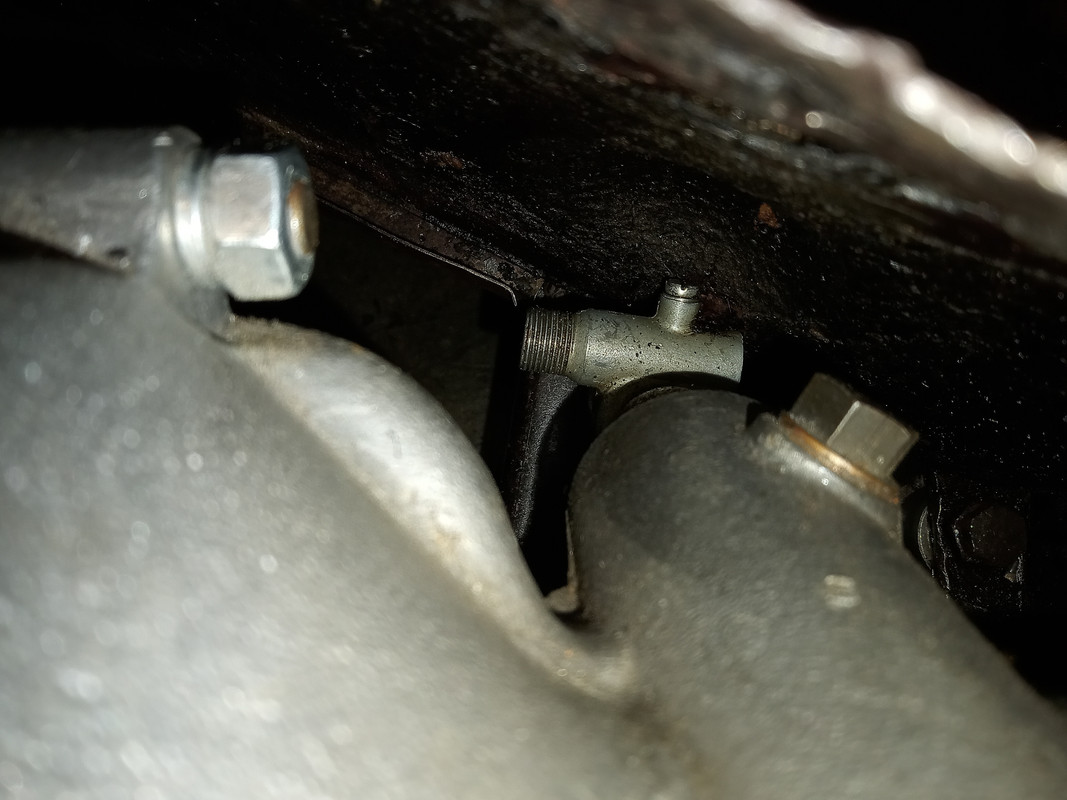

Here are pics with the OD installed. With the gearbox mounting spring compressed there is almost zero clearance between the speedo drive (side retaining screw) and the side wall of the tunnel...
Is this the same for others? What to do about it, nothing, or a bit of panel beating?

Not untypical to have to bash out the tunnel a bit......although sometimes they fit without.....Steve
