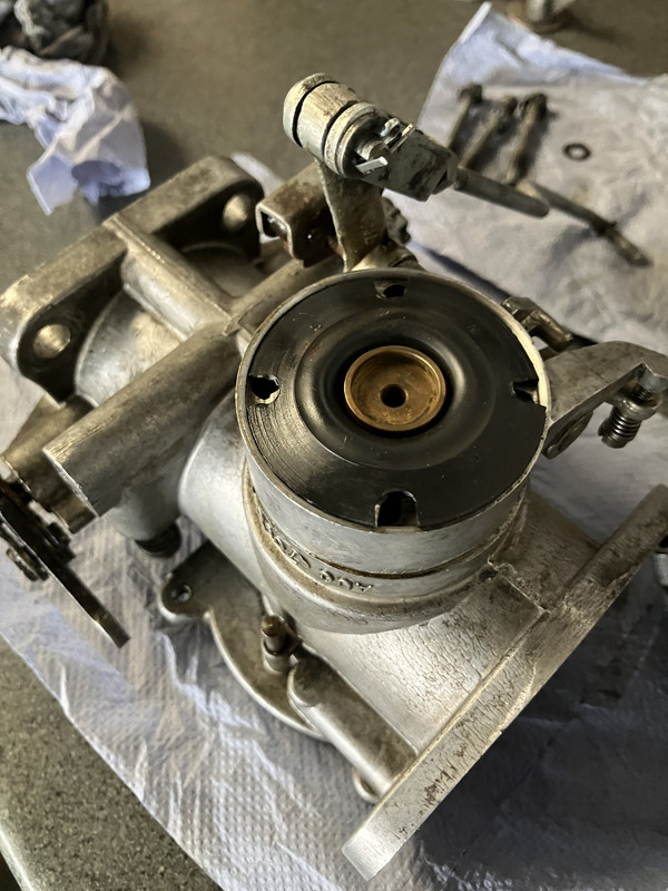

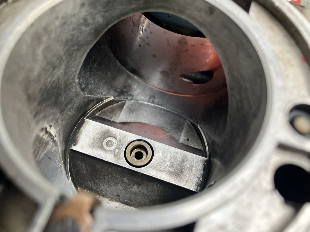

On removing the SU carb suction chamber and piston, I could see all three carbs had their jets in the retracted choke position within the jet bearing. I tried to pressurise the fuel system and fuel was rapidly leaking out of Number 1 carb jet around the jet needle. I can only assume the jet had been pulled down when the choke was engaged and become stuck within the jet bearing and the return spring in the base of the carb could not overcome the stuck jet to cause the fuel to leak around the needle.
On removing Number 1 carb - which was fun hard up against pedal box housing - I found the jet firmly stuck in the jet bearing.
I understand that all three jets were replaced about two years ago as there was a problem with the diaphragms, so what has caused these new jets to stick firm ?
Is there any work that needs to be undertaken to the jets within the bearing to avoid this problem ? I understand that the jet bearing needs to be centred as the pistons fell smoothly onto the bridge, so I don’t believe there was a problem with the jet bearing alignment.
Any thoughts what caused the jets to lock solid ?
