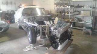

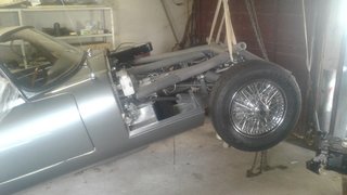

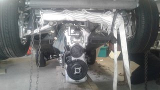

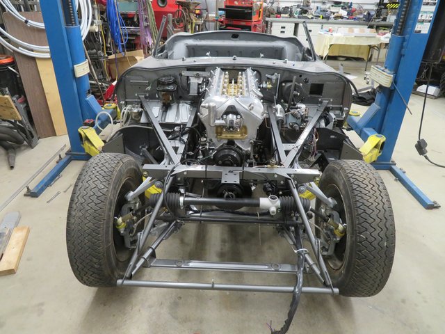

Hi Mike
The torsion bars can be in place. Here is a couple of pictures from my bottom installation.
Mike

You can install the engine from the bottom with all the suspension intact, there’s not an awful lot of room but a bit if juggling it’s an easy job .. I’ve just done it that way myself using only a trolly Jack, I did first have the engine on a skate which helped no end in getting it under the car and in position..

Installed mine that way, had the engine on a dolly & hoisted the front of E up by a steel beam in my garage using a chain block. Took less than an hour.
