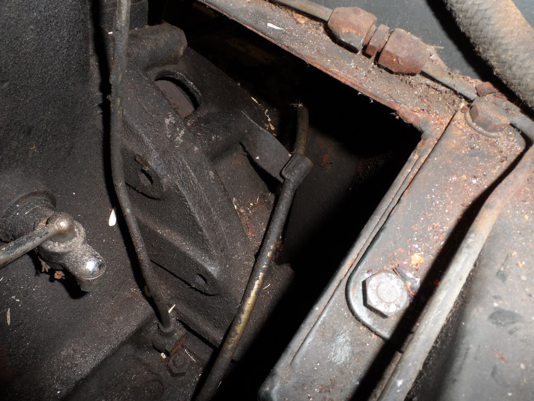

#3 Re: S.1 RHD Speedo Cable Clip C17140
Post by Ian Howe » Fri Jan 13, 2023 10:10 pm
gmunro
Posts: 119
Joined: Mon Apr 07, 2014 4:34 pm
Location: Hillsborough, Northern Ireland
#4 Re: S.1 RHD Speedo Cable Clip C17140
Post by gmunro » Sat Jan 14, 2023 12:32 pm
Hi Ian,
Many thanks for the picture. It is hard to identify exactly where the clip is bolted to. Can you please tell me exactly where on the car this picture is taken?
Thanks for your help and I look forward to hearing from you.
Kindest regards,
George

#5 Re: S.1 RHD Speedo Cable Clip C17140
Post by bitsobrits » Sat Jan 14, 2023 2:41 pm
Clearly it is bolted to the left side of the stabilizer bracket that is directly behind the engine on the firewall. :wink:

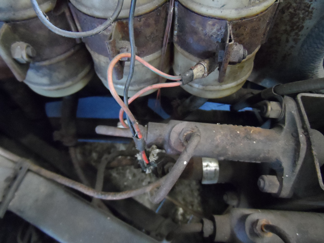

Ever wondered about those two holes in the stabiliser 'A' bracket on the bulkhead are for?
The early LHD cars had the clip bolted to the A frame as shown in Ian's photo above. On later LHD cars there are two clips, one on the pedal box and the other bolted to the bell housing:
2026 Lexus LBX
Ian Howe
Posts: 59
Joined: Wed Dec 02, 2009 1:57 pm
#7 Re: S.1 RHD Speedo Cable Clip C17140
Post by Ian Howe » Sat Jan 14, 2023 4:58 pm
Hi David
This is 875039 - showing the bell housing clip and the 'P' clip attached to the top brake master cylinder inside bolt. I think this was always the configuration for LHD.
I forget where I got the photo posted in answer to the question about RHD C17140, but I had assumed the bracket is on the left hand side guiding up the speedo cable from the smiths drive on the left.
Ian
Posts: 15204
#8 Re: S.1 RHD Speedo Cable Clip C17140
Post by Heuer » Sat Jan 14, 2023 7:53 pm
With the C17140 it will only work in one orientation and that is to the drivers side of the A frame (I have tried both ways, and only one works). The clip supports the cable from the speedometer as it comes out of the bulkhead.
I assumed your photo was of an OBL. I will do some more research into LHD configuration.

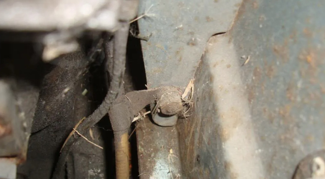

Posts: 15204
#9 Re: S.1 RHD Speedo Cable Clip C17140
Post by Heuer » Sun Jan 15, 2023 1:21 pm
Done some more deep research with the help of Ian Howe. This is the correct position of the clip on RHD cars:
And confirms Ian's photo as being correct:
It is a bit of a relief to be honest as the clip is easy to fit on that side and almost impossible on the other side with the engine in place.
