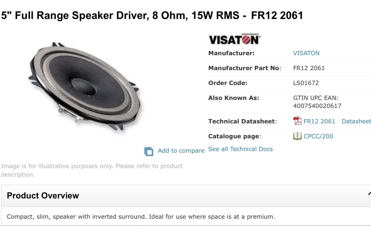

I’ve been running a Blaupunkt Köln for years now and although my speaker connections are at the side of the radio amp casing, they are of a similar with the three pins. Stereo speakers option had the four pin layout. I’m using 8ohm speakers and purely as these were the slimmest I could find. I did run them initially off the 4 ohm single speaker pins but once I found the correct pins for 2 speaker parallel, it made a big difference. Also wiring speakers in anti phase helped. What I did find out, during my investigations with the Blaupunkt vintage radios, was a warning not to switch radio on without speakers being connected. My pin layout is at the bottom here but same theory. This May help:
