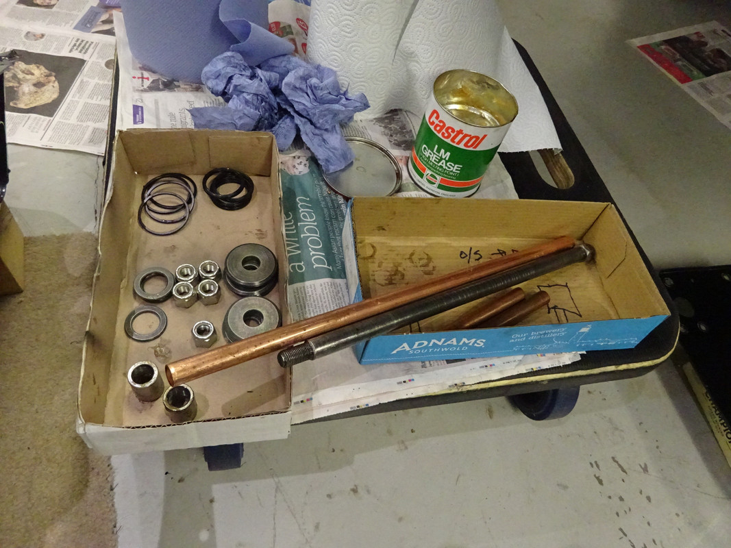

4) Another basic cheap reassembly “tool” is to get some 15mm copper pipe from your local plumbers merchant. When reassembling the various bearings, seals and thrust washers into the end of the wishbones, smother them in grease so they remain in place and pass through a 1 1/2” piece of the 15mm copper pipe at each side to retain these as you fit the wishbones back between the Inner Fulcrum mounting bracket and the cage. Once in place, push a long length of 15mm copper pipe through to push out the two 1 1/2” pieces to form a dummy shaft right through the whole assembly. When putting the Inner Fulcrum Shaft back into place, gently hold the dummy shaft in place to ensure all the components remain in place.
In mentioning the Inner Fulcrum Mounting brackets, if you choose to send the Differential away for someone else to work on - assuming it needed any work done - ensure you know where these are physically located, or make the point that you are supplying the Diff with these currently fitted as these are unique to the E Type and extremely expensive to source and will avoid any confusion at a later point !
