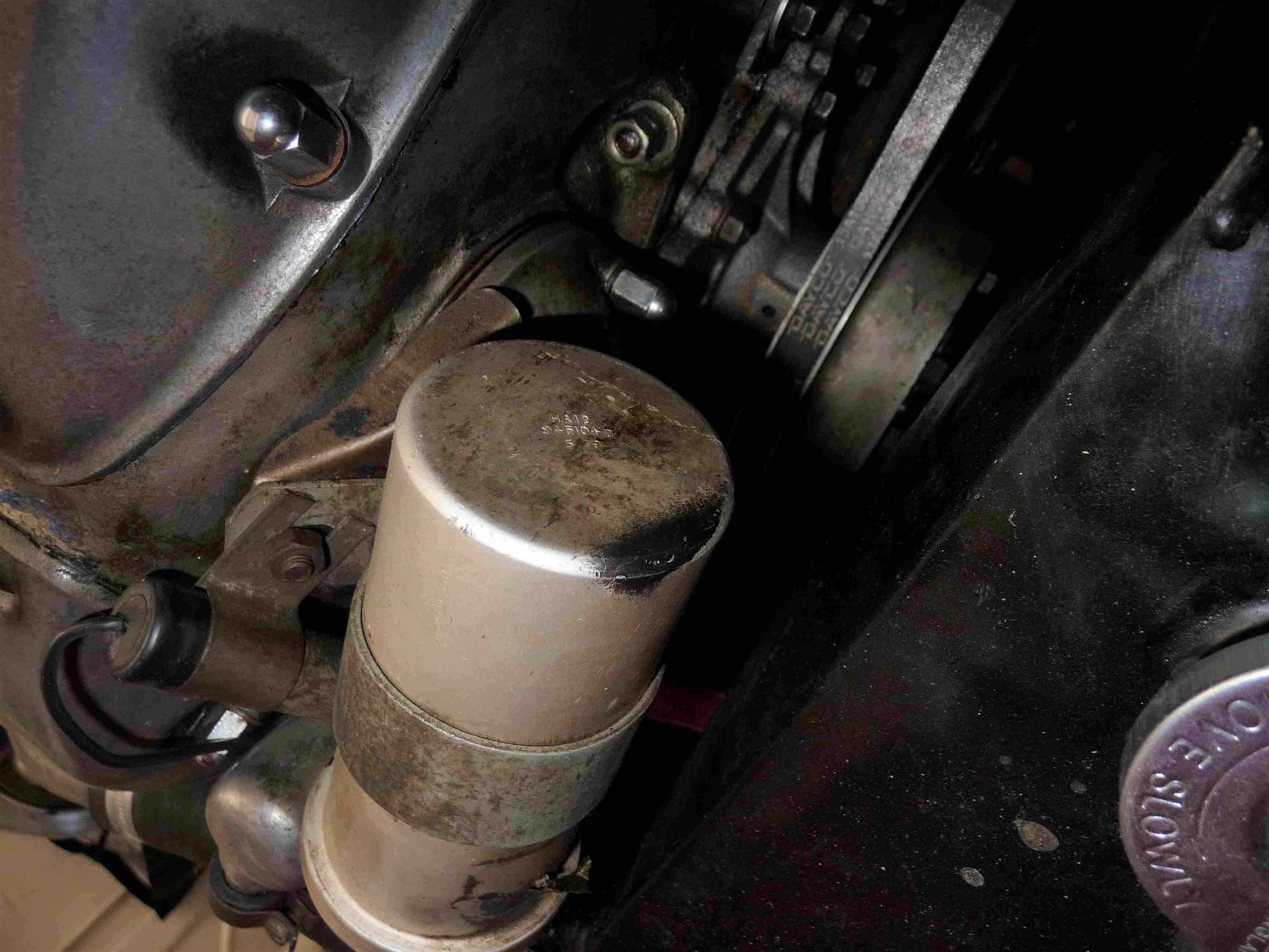

Here another one from 5th month of 59, for my car of october 61, with a similar lead time:
I have a related question.
My car has what seems to be an electrical capacitor besides the coil that I have not seen on other 3.8s.
Is it due to the use of that HA12 coil?

#7 Re: 67fhc, should I use old coil (tested, yes)
It looks like a suppression capacitor to reduce radio interference.
