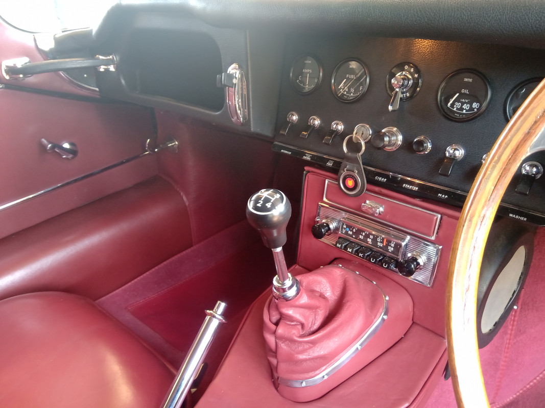

Post by Allrand » Thu Apr 04, 2024 6:57 am
IIRC it goes in below the metal top, held in by metal tabs as indicated by Steve. There is a thin leather covered wooden panel over the steel top. The attached pic is a 3.8, I think the 4.2 is slightly different. Missing on mine is the upholstered piping around the edge of the shift cover, just not enough space due to the thickness of the new leather.
