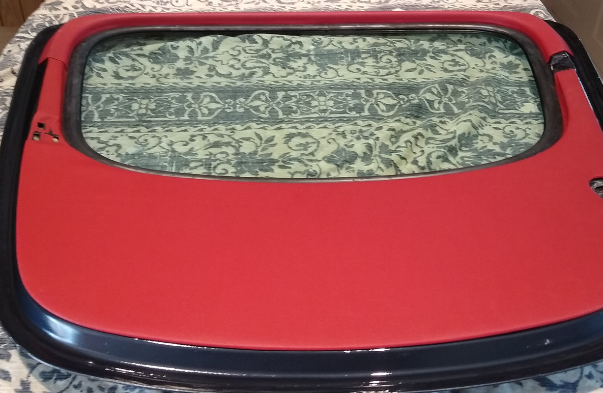

Yes, it's a tricky job but patience and an investment in decent windscreen fitting tools pays off. You get the feeling that the chrome is going to creep its way back out, and sometimes it does during the fitting process, but careful manipulation as you go ensures it stays where you put it. It is necessary to tweak and twiddle with the form and profile as you go - don't expect it to fit straight out of the bag (does anything like this ever fit?).
This is mine, which I did on the kitchen island with kind permission of domestic management. I didn't use any adhesive. It remains to be seen whether it stays in place once it sees active service but it has stayed in place for a year or so up until now.
