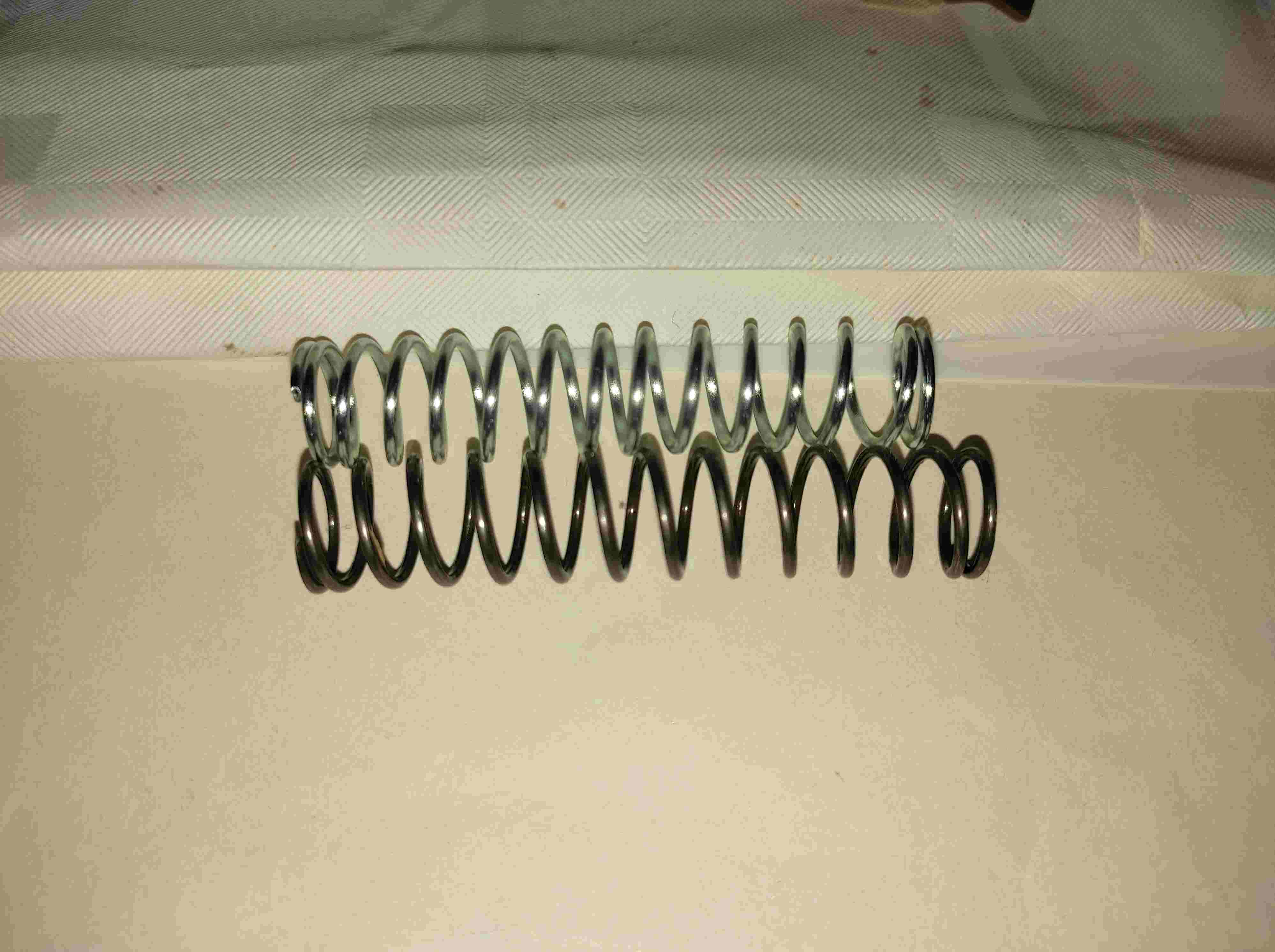

When I bought a replacement spring from SNGB, the new spring was shorter than the old one.
Old one bronze colour and new one silver colour in the picture below:

I’ve assembled and fitted the filter unit but not yet run the engine. I’m not sure what expect anyway.
The new spring was definitely longer than the old. The colour of both was similar and not silver on the new.
How did yours perform?
