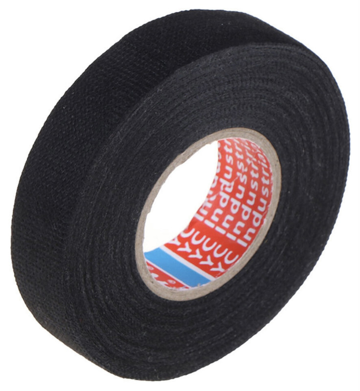

I used cloth fabric tape on the eyelets, from the usual outlets/auction sites.

Post by Series1 Stu » Fri May 19, 2023 12:20 pm
:yeahthat:
Or a thin layer of self amalgamating loom tape.

Post by Dr-G » Fri May 19, 2023 1:35 pm
Thanks for that - good idea. TBH I assumed they were the same things. I ordered some fabric self-amalgamating tape from Amazon just now.

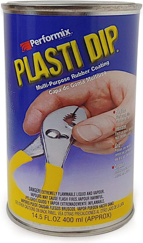

Seat belts, manufactured by Britax and supplied by Jaguar, were attached to grey plastic coated eye bolt anchorage points and each one had a spiral bound wire with a lead seal from the Factory. The seal is stamped “Jaguar” on one side and “FW/M 229A” on the other. FW/M 229A is a Jaguar part number which refers to the eye bolt (although I cannot find a reference to it in the SPC). These, along with the required fittings and the belts, were supplied as a complete kit for Dealer installation.
If you want to replicate it you can use grey Plasti Dip available from Amazon as either a spray or brush on can. The layer is thin enough not to interfere with correct operation but prevents rattles; it can be re-applied easily if it wears off:
