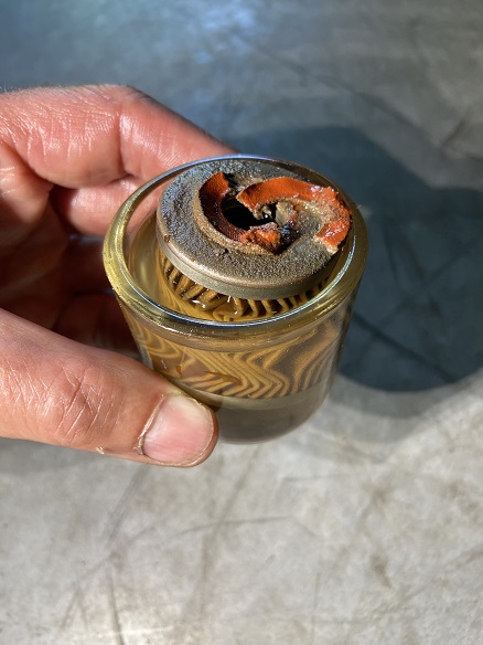

Here is suspect number 1 on my list, the fuel filter :
Wow it looks ugly in here !
From what I see in the filter, I'm going to check what's going on in the fuel tank !
However what's the good set up (stock or upgraded) for fuel filtering on an Etype ?
Thanks for your help !

Olivier, start with simply replacing the element. SNG Barratt’s will supply them.
An alternative filter is the Malpassi Filterking, search on here to find comments.

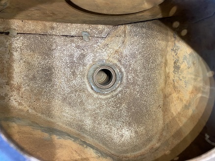

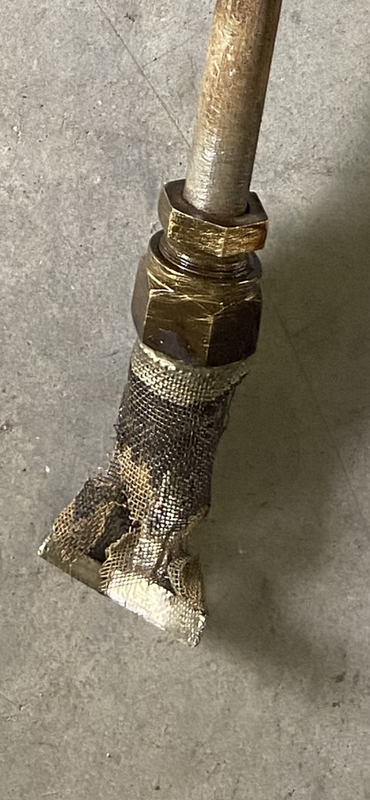

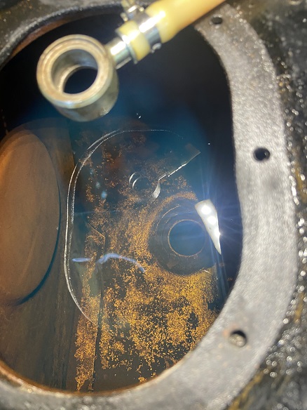

After seeing how bad the fuel filter is, I've decided to go check the gas tank.
Gas tank seems OK, but I will drain it to have a close look and check the sump.
However the pickup tube filter is badly damaged so I will replace it.
Olivier

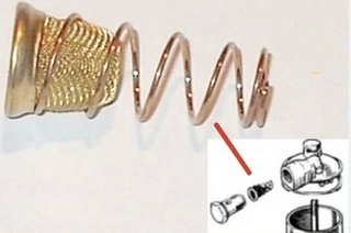

Maybe also replace the gauze filter located in the top of the fuel bowl too, (easily missed);

I've cleaned the gas tank by draining it, then I brushed all I can with a long paintbrush (33cm) going through the pickup tube opening and the fuel gauge sending unit opening. I then vacuumed it, and rinse it manytime with some paint solvent until there would be no residus in the sump hole after feeding some solvent into the tank. Quite long but worked quite well.
Now the tank is cleaned, the new pickup tube filter fitted, everything is bolted back up and the tank is full of gas again.

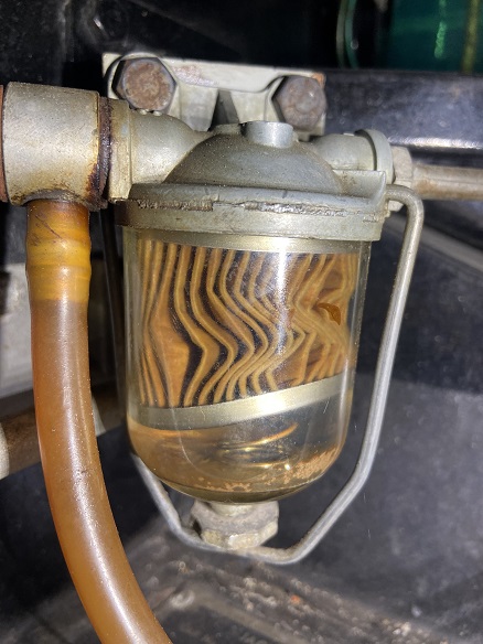

Next I'm going to clean and refurbish the clear glass fuel filter in the engine compartiment.

The main point is that the filter in the glass bowl is fed with fuel from inside to the outside, so the glass bowl remains visually clear of debris, but could be seriously blocked internally. This allows the car to run to a certain fuel flow, but when higher flow is needed the engine will stumble. Easy to check by removing the filter and trying to blow through it. As it is such a cheap component, it is worth carrying a spare and also changing it anyway if the previous history on the car is unknown.
The other points raised in this thread could prove of interest, such as the fuel cap breather, the general condition of the fuel tank and fuel piping, plus the three separate fuel filters if you are running SU carburettors.

Fuel filter is cleaned and back on the car.

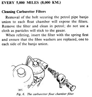

How can I clean the filters on my 3 SU'S and maybe the Su's themselves ?
Thanks a lot for your help !
Olivier
Olivier
1965 4.2 E Type OTS
caveman
Posts: 711
#15 Re: 4.2 Engine cuts erratically
Post by caveman » Tue Jul 04, 2023 7:38 pm
1965 S1 4.2 FHC (early)

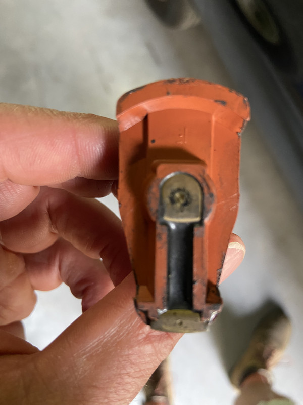

After cleaning the gas tank, fitting a new pick-up tube mesh and replacing both fillters and the rubber gasket in the fuel filter, I also took off the fuel filters at the carburetors and cleaned them (but they were really clean anyways). After that I went for a test drive with the fuel cap off..and after au few miles when trying to rev the engine a bit it shut off again.
So I think I will try to replace the distributor rotor arm and the coil and see if that helps.
Which coil do you recommend ?
Olivier
1965 4.2 E Type OTS

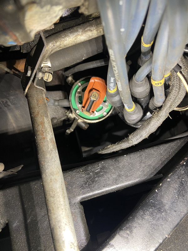

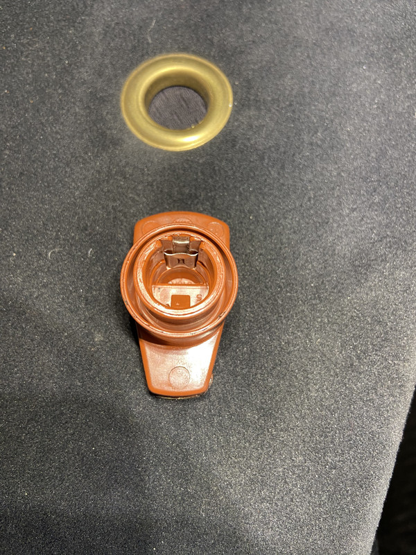

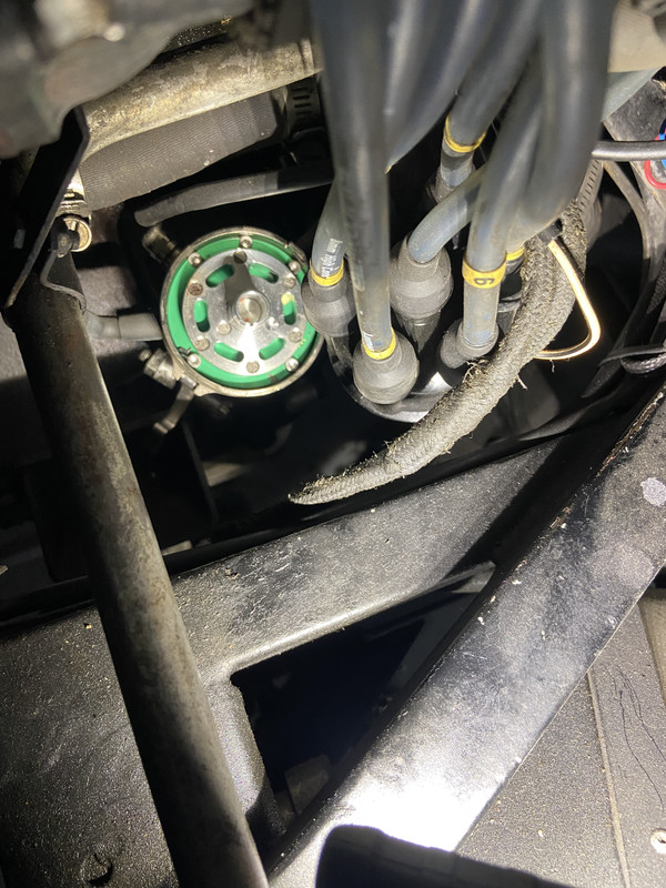

From the photo, that is most definitely not a usual rotor arm, and the distributor looks very different from standard - it might even not be a Lucas one. before you order anything, I think you need to establish the exact specification of what you are running
Posts: 1597
#20 Re: 4.2 Engine cuts erratically
Post by chrisfell » Wed Jul 12, 2023 12:13 pm
That looks like a Bosch rotor arm as fitted to a 123 dizzie. If it is, note that the life of the 123 dizzie cap and rotor arm is quite short. 30,000 Kms or 18,000 miles. The central electrode in the dizzie cap wears out, and misfiring starts. Replace them both. Check the part numbers on the 123 information sheet.
I've just looked at the photos again. I see a 123 dizzie and rotor arm but not an orange Bosch dizzie cap.
